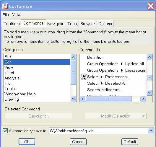

    Add this to your toolbar, black arrow on grid. It will allow you to turn it
    on and off. Its under the list of commands on edit.

    November 28, 2007
    Stephen,
    What version are you using?
    In my WF2 release, I can find neither the "Arrow on grid" icon or the
    one immediately to the left of it. What is that one for?

    November 28, 2007
    Wildfire v3
    Best regards
    Stephen

    November 28, 2007
    One on the left of it is for colours and appearance.
