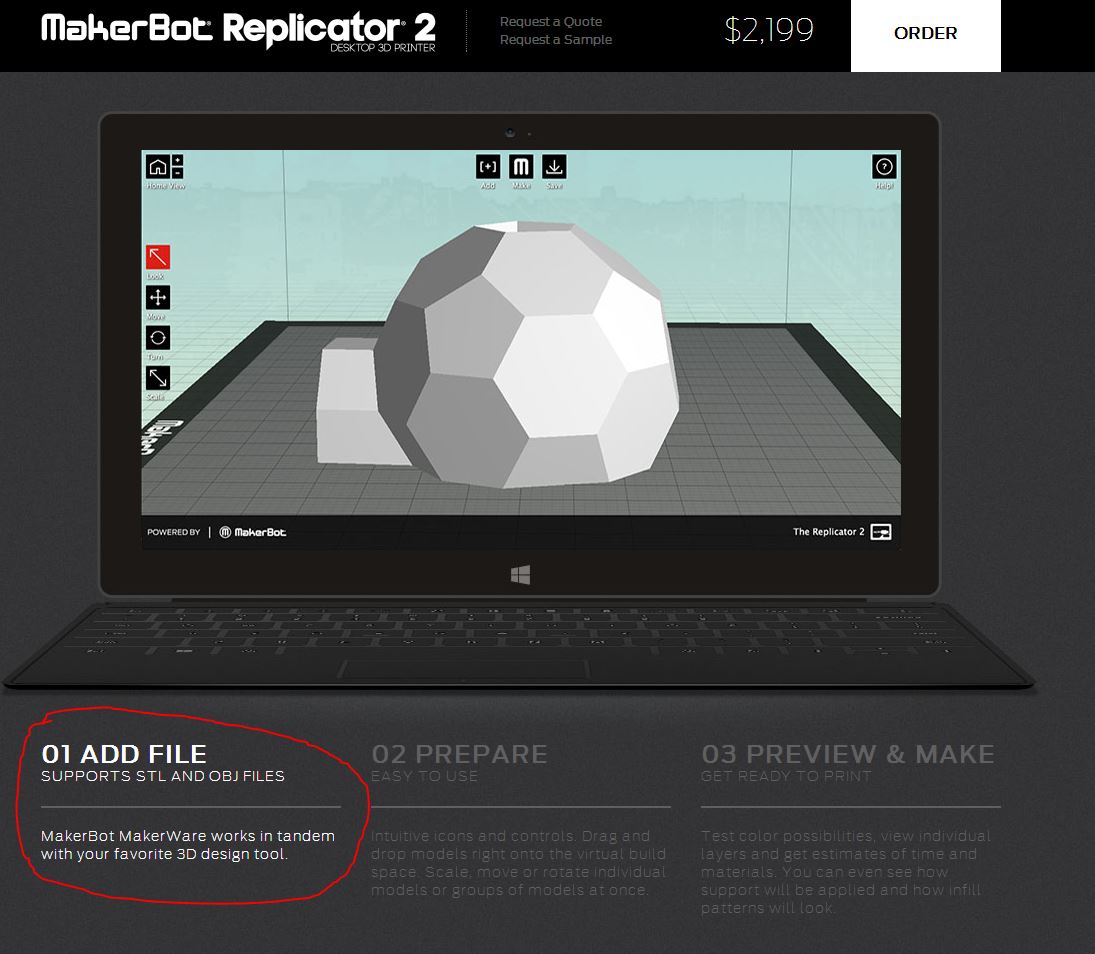

I am thinking about buying a Markerbot Replicator 2 will it be compatible with PTC CREO 2.0?

Compatible in what way?
Years ago I ran a Stratasys FDM, and the way it worked with Pro is you export your model as STL, and then import it into the software (I think it was called Quick Slice?) and the software generated the path and sent it to the printer.
It appears Makerware is similar.

We have a replicator 2x and Creo Parametric 2.0. Creo makes the .stl file that will go directly into the Makerware software provided by Makerbot. This is smooth and works well.
I would not recommend the replicator 2x machine that we have, the end parts do not come out dimensionally correct. We generally have to print, measure, scale and print a 2nd time to get it right. I think the replicator 2 you mentioned will be a better machine as it prints PLA which is more stable.
