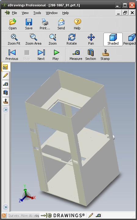

    I think you can still get a free version on the eDrawings publisher. It
    watermarks the file as being published with the free version, but
    functionally it's the same.
    January 30, 2009
    The eDrawings publisher for Pro/E has a free version that installs on your machine but won't allow the person viewing the file to make measurements or sections of the published parts or assemblies.

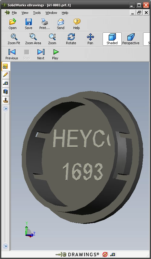

    January 30, 2009
    Actually eDrawings will view Pro/E models directly.
    January 30, 2009
    You are correct .. So I tried it with eDrawings 2009 SP2 (We only have SW
    2008 so I believe this is the free viewer.) and I was able to open a Pro/E
    file. I suspect maybe you have to have some version of SW installed too.
    I do know that trying to open an assembly you must have all the parts in one
    folder and the instance accelerator files for the family table parts.
