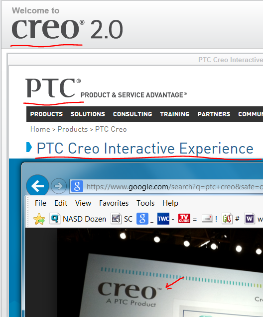

I am wondering if PTC is willing to provide the PTC fonts for Creo users so we can make accurate logo's for projects.
If not the font, maybe a series of approved sketches that can be used for extrudes or offsets.
Most companies would love you to use official logo art rather than trying to create a sketch outlining a small jpeg.
Can you enquire about this for us?
And in this same vane... TM vs R... I've seen "Creo" both registered and trademarked. Can someone in the public relations office clarify appropriate use?

I found out a few things.
  1. We can not provide you with the font because it is licensed
  2. If you're a Partner of Reseller, you do have access to logotypes, collateral, guidelines and images via the Partner Portal. You can request access to the Partner Portal.
  3. I could provide the images to the main product family logotypes here on PTC Community. Let me know if there is interest.
Sep 16, 2013 5:27 PM UTC
I probably have to settle for 3. If you could please attach a high rez PTC and Creo logo of the stylized font, that would be great.
