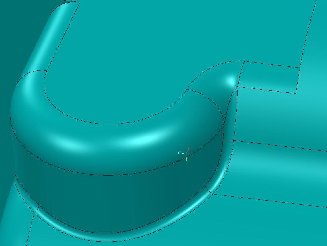

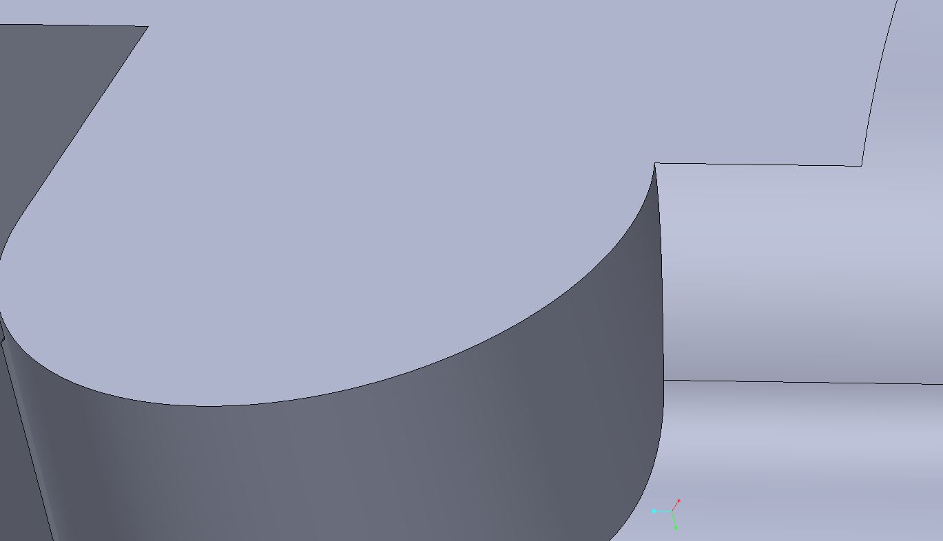

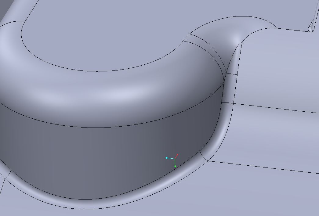

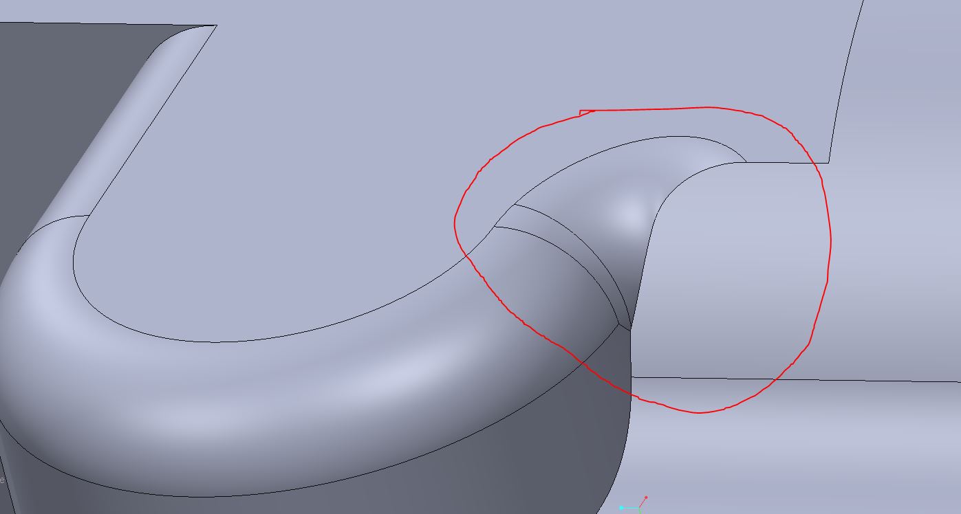

CREO2 M120. remodeling a geographical nightmare that someone created. Pic 1 is what I need to do, pic 2 and 3 is removing it with Flex, Pic 4 is putting it back on with normal radius tool.
And ideas? I thought there was a way in the past to stop radius from being created on tangent chains? maybe that would do it?

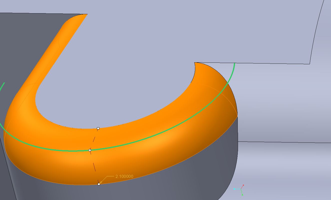

There is also a .5 radius on the lower side, Pic 5, this might be key, too. What I dont have is a good picture of what they look like blended together, although it is amazingly close to Pic 1. (it doesnt wrap around like you would think; it just ends).
Pic 5 the radius isn't supposed to continue to the right. (pic 5 is putting the .5 radius on first.)

    This is the goal.
    Aug 23, 2014 2:24 AM UTC
    Emailed you back a reply. It seems that following a curve on the top surface is the best way to terminate the round. I did make the 0.5R first. This is the "through curve" option for rounds. The curve sets the radius so it can be continually variable. I believe the curve is required to be tangent from start to finish.

    It wasn't a matter of which edges were selected. It was a matter of how it did the blend at the end. There are two transition solutions but you have to have both sets in the same round feature.
    I am not sure how Matt finally got to his solution but I ended up with the same geometry using the transition button.
