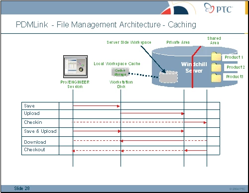

    This slide from our Windchill training helps show what each option does and how the file is stored.
    [cid:image002.png@01CDADE4.2E7E72C0]
    This slide illustrates how data moves through the system from a Pro/E session to a Windchill shared folder
    The solid lines show the main purpose of the different commands (e.g. checkin moves data from a users private folder to a shares folder)
    Dotted lines show where the Wildfire integration is optimized to allow multiple operations to happen with one end user action (For example, if the user checks the "Open in Pro/E" checkbox on checkout, objects will be checked out to the user's private folder and files will be downloaded and opened in the user's Pro/E session)
    There are four locations that file data can exist in, and the Wildfire integration is responsible for marshalling that data between these locations as a result of user actions
    Check Out
    During a check out operation, data is transferred from the Windchill database to the workspace. Optionally, if you choose to open the object, the data is then transferred from the workspace to Pro/ENGINEER.
    Check In
    During a check in operation, data is transferred from the workspace to the Windchill PDM database. If you check in an object directly from Pro/ENGINEER, the data is transferred from Pro/ENGINEER to the workspace and then to the Windchill PDM database.
    Upload
    During an upload operation, data is transferred from the client-side workspace to the server-side workspace.
    Download or Update
    A download or update operation transfers data from the PDM database to the workspace. You perform an update, to update existing and potentially out-of-date object information in the workspace from the PDM database.
    Process for updating objects in WS:
    Use "Update" if object current status is "Checked-In"
    User "Download" if object current status is "Checked-Out"

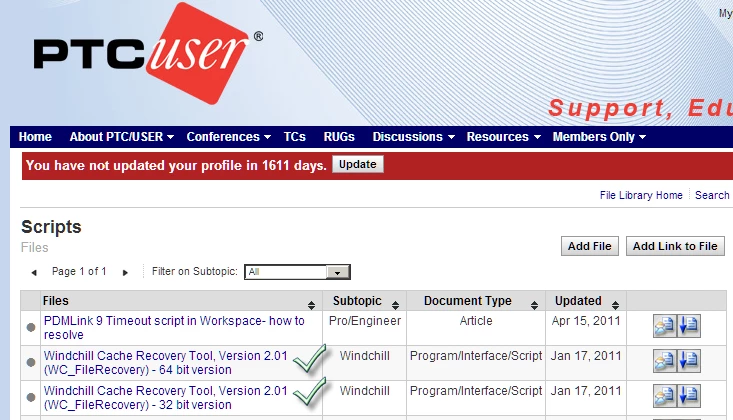

    [cid:image002.jpg@01CDAF5C.185666A0]
