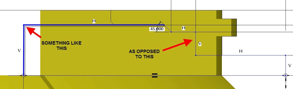

SKETCHED Line Thickness
Is there an option to modify the SKETCHED Line Thickness?
Being color blind, it can be a challenge when working with complicated
parts....Doh!
Thanks in advance!
-Art
ProE Wildfire 2.0

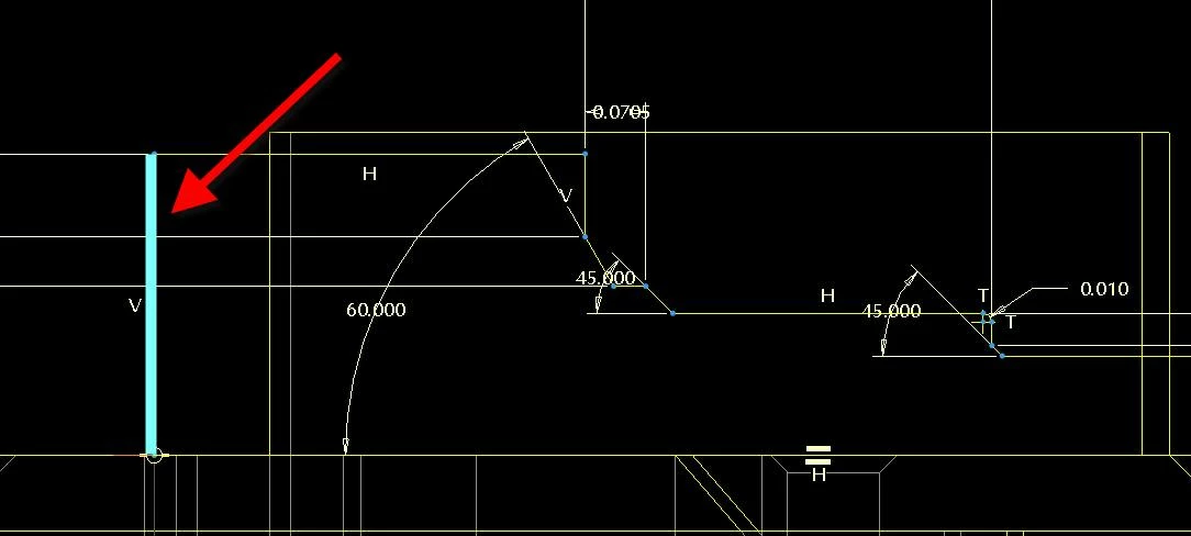

    agaribay1-VisitorAuthor
    Is there a way to change the SKETCHED Line Thickness in WF2? It would
    be nice if the sketched entities were bolder.
    Thanks you.
    -Art

    Changing the thickness is only possible for plotting.
    You can change the color, though: View > Display Settings > System Colors and change the Sketch color.
    Then save the settings to a file. You can copy the file contents to Your config.pro to load it automatically.

    Also being color blind, I found that playing with the line colors until you get a good contrast... or you could change the line font -give sketched lines a phantom or abroken font. Have you tried that?
