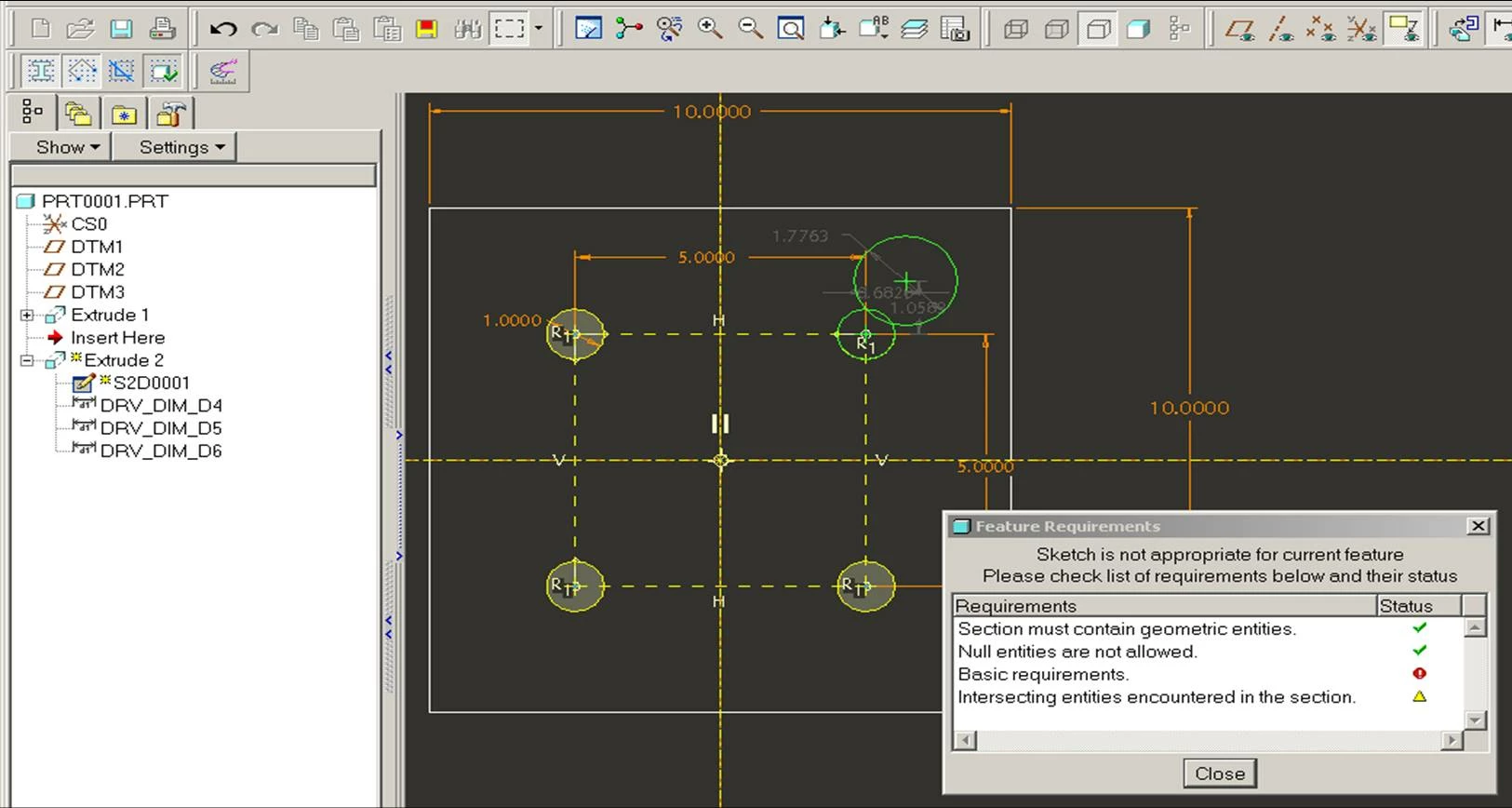

    Have you seen the Sketcher/Intent manager in Wildfire 4.0?!
    It can shade closed sections, quickly show you where entities intersect and the Feature Requirements” button can help you figure out what is wrong with your sketch.
    Dave
    Nov 6, 2007 9:26 PM UTC
    Now that is a nice feature. Will it show you where you have an entity
    on top of another one?
    Doug
    Nov 6, 2007 9:34 PM UTC
    Judging by your screenshot, this looks like a terrific idea, implemented at about 80% efficiency, which is about right for most new PTC stuff. (Sorry, PTC guys, but it's true.) What kind of use is the "Basic requirements" warning? What does that mean? If I were to encounter this while working in Sketcher, it would tell me nothing useful. That's right up there with "feature cannot be created."
    I assume that you can click on the "Intersecting entities" line and they'll highlight for you, so that you know where they are, yes?
    Okay, I guess that's 75% efficiency, since three of the four "warning" lines are somewhat self-explanatory.
