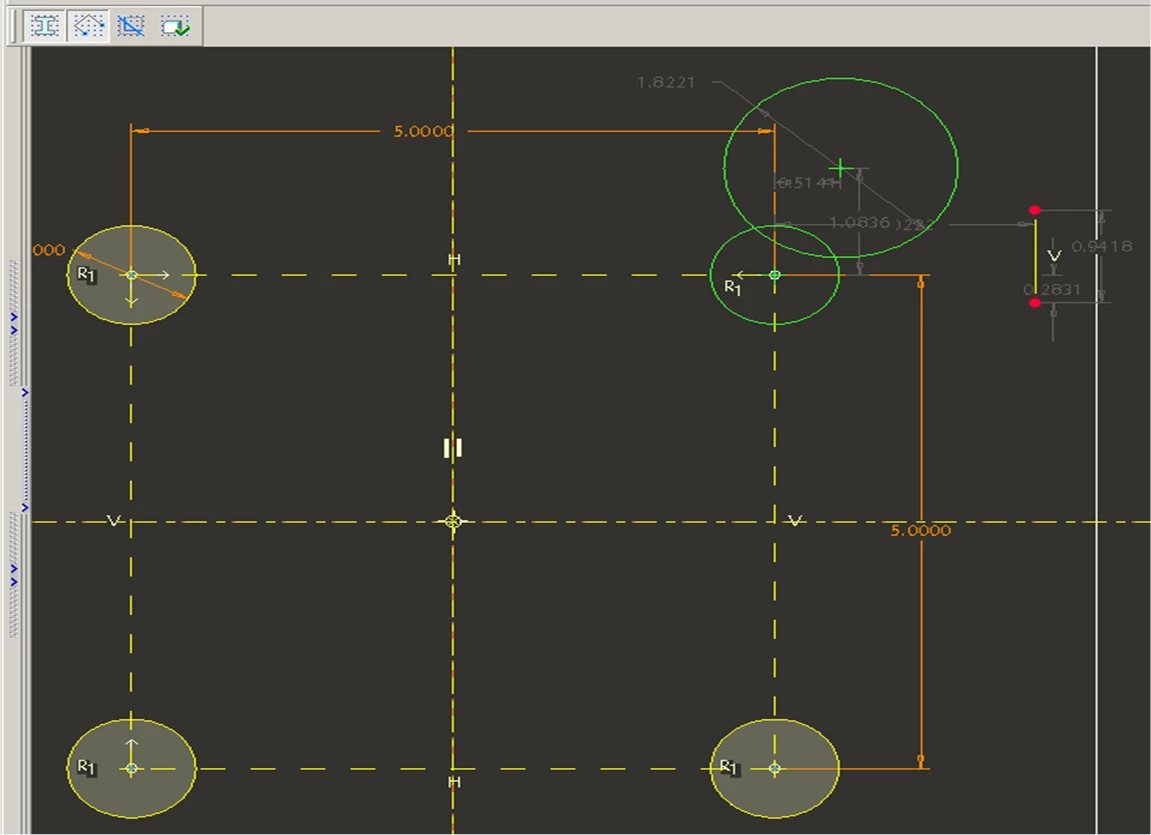

    This is part of what they apparently callthe sketcher diagnostic tools in WF4. (See the new buttons). One to show closed sections, one to show intersecting entities, one to show unattached ends and one to run the diagnostics box. Reminds me of a spell checker.
    Anyway, I've always been a fan of Intent manager.
    Nov 6, 2007 9:42 PM UTC
    Tim,
    Have you downloaded Wildfire 4.0 Pre-production and tested the sketcher
    diagnostic tools we've added? I would be very interested in hearing your
    feedback (or anyone else's) on what other diagnostics are required.
    FYI, we added the following diagnostics in sketcher:
    Shading Closed Loops
    Highlighting Open Ends
    Highlighting overlapping and intersecting entities
    Feature Requirements (this dialog posted earlier)
    Thank You,
    Netesh Gohil
    Director of Product Management
    Pro/ENGINEER
    PTC
    973-631-6197
    <">http://www.ptc.com/company/tl/index.htm>
