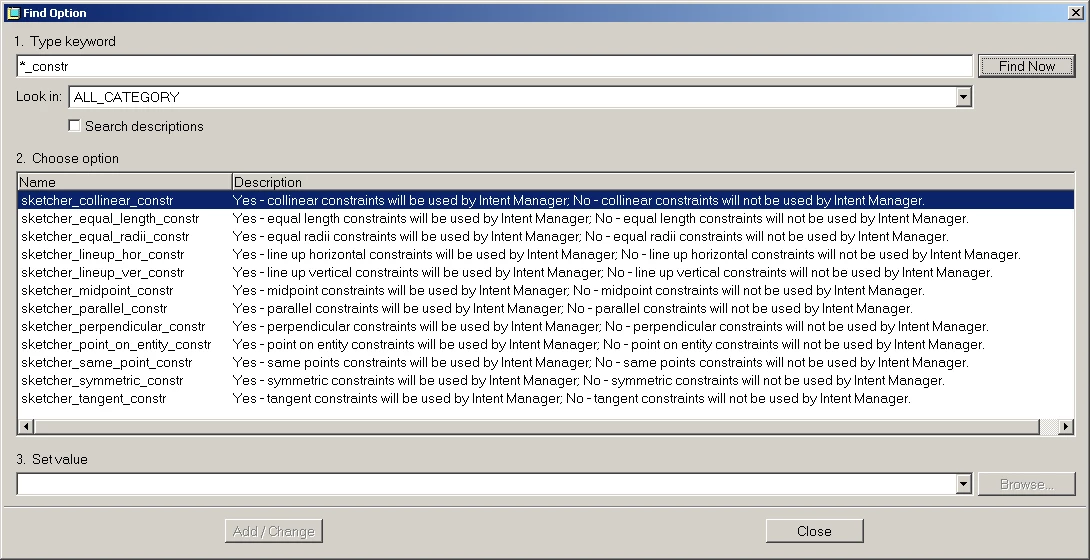

    You guys need to look in to the later builds of Wildfire 3.0. At some
    point PTC added a bunch of config options for sketcher. All of the
    options end in "_constr" and are used to individually turn on or off
    particular intent manager constraints.
    Dave

    A correction/addition to Lyle's post. The "skamps" config options
    control whether the constraint symbols are shown or not. To set the
    constraints to not be added automatically, set the following options to
    no.
    sketcher_equal_length_constr
    sketcher_equal_radii_constr
    sketcher_lineup_hor_constr
    sketcher_lineup_ver_constr
    sketcher_midpoint_constr
    sketcher_parallel_constr
    sketcher_perpendicular_constr
    sketcher_point_on_entity_constr
    sketcher_same_point_constr
    sketcher_symmetric_constr
    sketcher_tangent_constr
