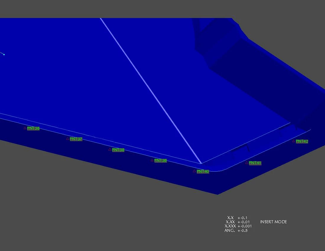

    I have another question related to the previous email. I would like to add a
    vector thru each DTM point normal to the surface. Besides using a hole with
    a small opening, is there an easy way to do this?
    My client has asked for no holes if possible, as these will be added later.
    I have thought about creating an axis, but I cannot control the length of
    the axis.
    I would appreciate any helpful suggestions. If this feature can be patterned
    (referencing the DTM PTS), that would also be helpful.
    Chris
    Jul 17, 2008 7:57 PM UTC
    you can control the size of an axis! if you right click and edit def. the second
    tab will allow you to control the size you can give it ref. or tell it a length
    Mike

    I found no easy (short) method of adding a vector thru a datum point to
    represent a hole location, without modeling the actual hole. The purpose was
    to export the file (STEP / IGES) with a curve showing the proposed hole
    location.
    . You can control the size of an axis! if you right click and edit
    def. the second tab will allow you to control the size you can give it ref.
    or tell it a length
    . Why not a curve from equation with a hidden csys attached to the
    point ?
    The client had requested only a vector be added to the model, and they would
    add the holes later. If anyone has a better solution, I would be interested
    in hearing from you.
