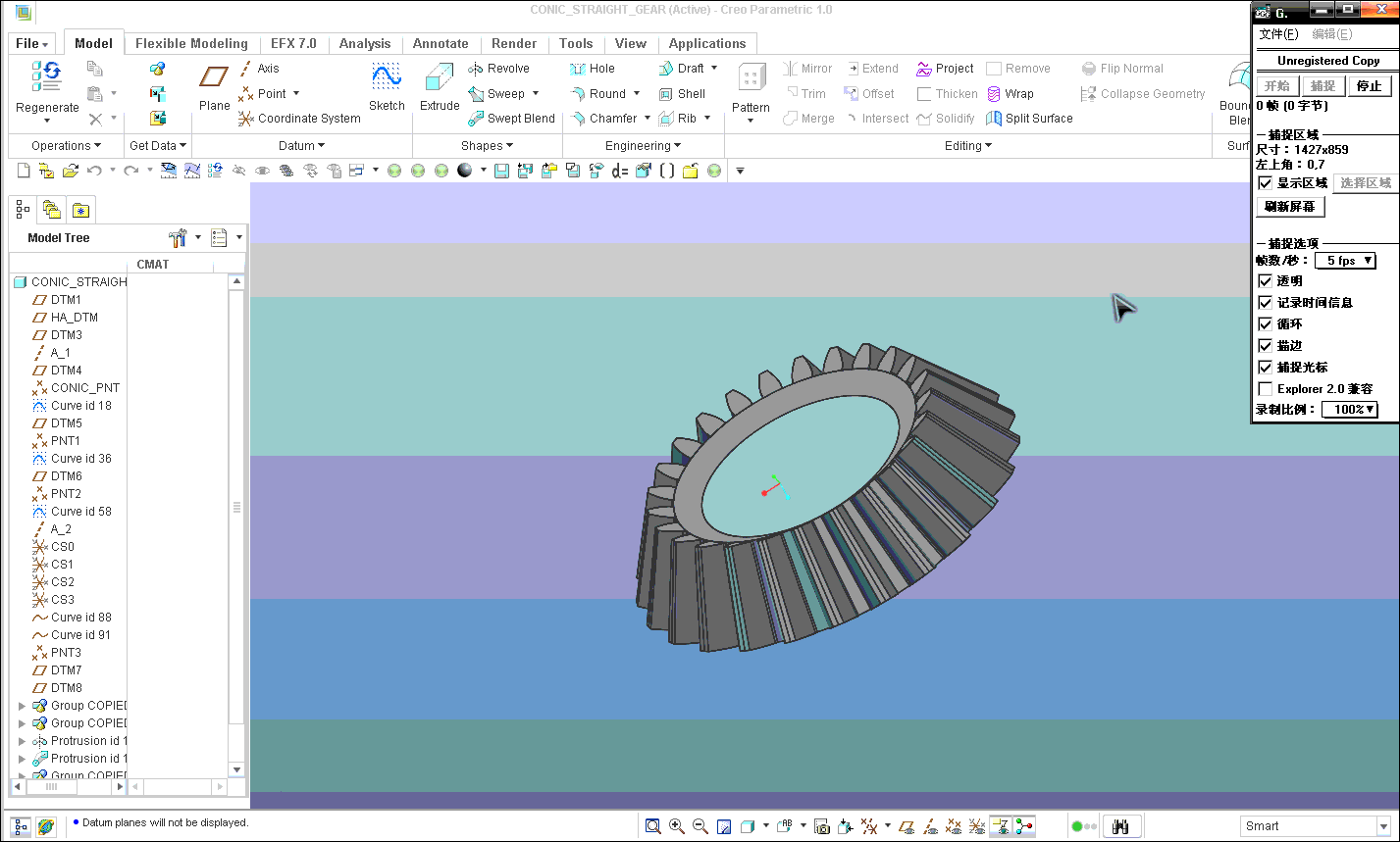

    Nov 3, 2011 12:18 AM UTC
    102.gifsee the picture
    Nov 3, 2011 2:45 AM UTC
    Thank you very much
    I have watched the animated gif and do not see the settings for Stereo 3D out
    Please advise
    谢谢

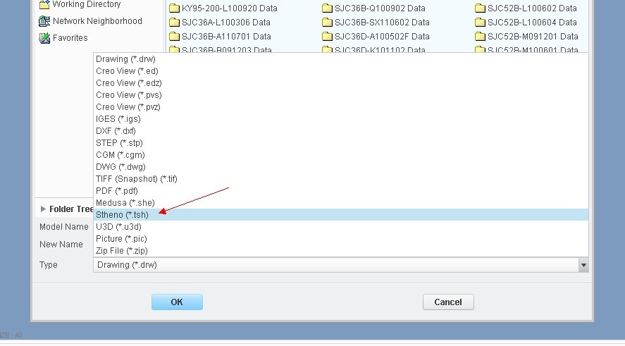

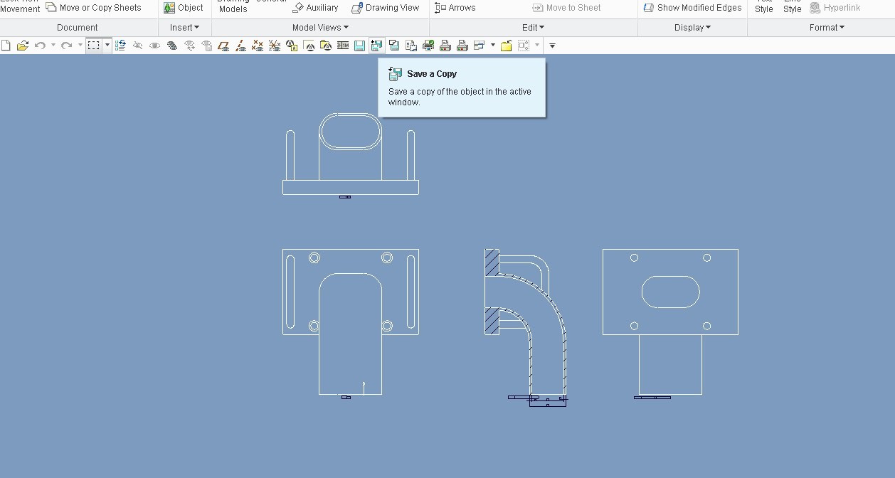

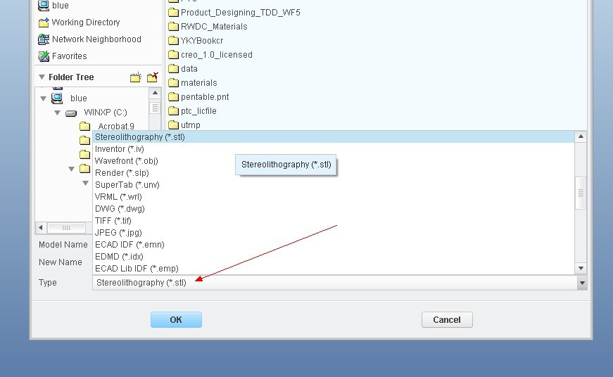

    Nov 14, 2011 3:14 AM UTC
    Nov 16, 2011 7:39 PM UTC
    Hi Michael...
    When I saw your question I thought for SURE there was a stereo option in the Render Tools... but now I'm not so sure. I have the Advanced Rendering Extension but I haven't checked that package yet.
    I believe when I did stereoscopic models from Pro/E, I actually output my models in Wavefront(.obj) format and used a secondary package to render the stereo images. I have a high end translator which allows me to pull Pro/E models into all sorts of other packages for animation/graphics purposes but the Wavefront .obj format is a freebie.
    If it's still available, freeware like POVRay may be able to generate the images you're looking for. I'll have to look more because I'm not sure there's a direct output in this stereoscopic format yet. I know the STL (stereolithography) that Blue DUncan suggested is probably NOT what you wanted. That's more for rapid prototyping.
