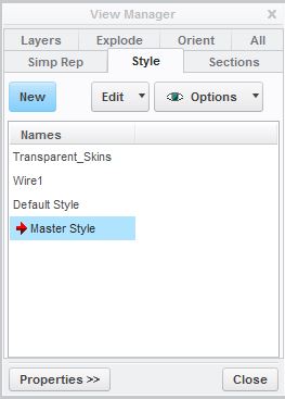

    For #1 (and assemblies) use the Style tab in the view manager. Click on style tab, then new, then component display style select the transparent button.

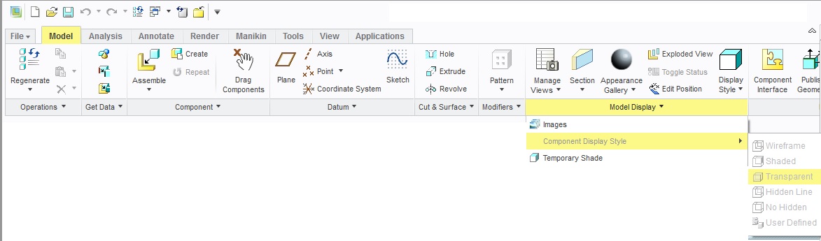

    As for #2 (and assemblies) it's located in the image below. Make sure you select a part first before you follow the links otherwise it will be greyed out as in the image below:

    1. Model Tab --> Manage Views --> Style --> New --> Show --> Transparent. Select the components you want to turn transparent and then save the style.
    2. Display it temporarily via selecting the components you want to be transparent and then: Model Tab --> Model Display [pulldown] --> Component Display Style --> transparent.
