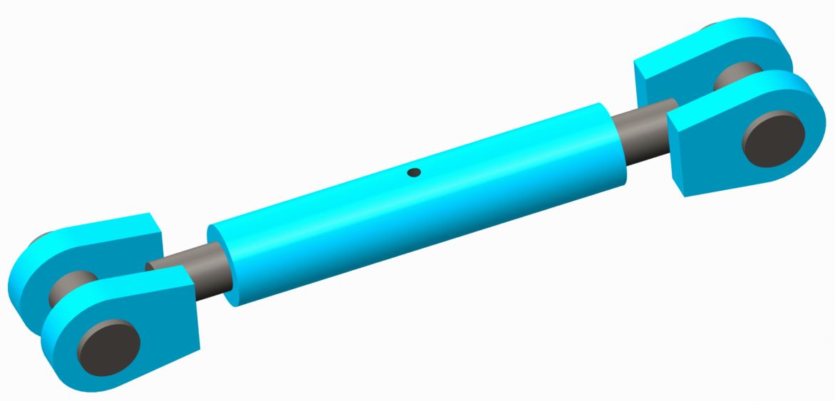

Turnbuckle with symmetric slider constraint
I have assembled a turnbuckle and I have placed the two spindles with 'slider' constraints. However, I would like both spindles to move symmetrically related to the body of the turnbuckle when one spindle is dragged. I thought that it was possible to create a relation that would make the distance from the body of the turnbuckle to the spindle half of the extension.
Does anyone have experience with this?

    2 helical sweeps, one left-hand, one right-hand, with cylinder and planar constraints on the center, and slider and slot constraints on the ends.
    Feb 7, 2015 4:00 AM UTC
    Rack and pinion gear relation in mechanism.

    That would work, but then the turnbuckle center wouldn't turn, would it? Mybe I'm trying to be too fancy.....
