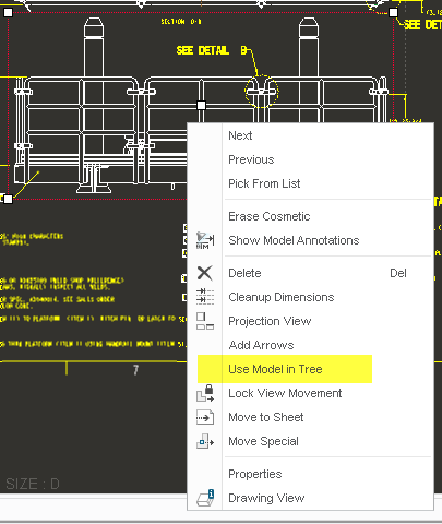

    Drawings bring back "Use Model in Tree" from Wildfire 4.0
    StephenW
    Nov 16, 2016 2:59 PM UTC
    Creo 3 M070. I know some releases of Creo 2 didn't have it.
    Nov 16, 2016 3:05 PM UTC
    My notes indicate that I implemented the restoration of Use Model In Tree in Creo 2 M150 and Creo 3 M030.
    StephenW
    Nov 16, 2016 3:15 PM UTC
    Matt,
    Can you mark Drawings bring back "Use Model in Tree" from Wildfire 4.0 as current functionaility and maybe include your notes!!
    Nov 16, 2016 3:22 PM UTC
    Hmm... I'm not sure how (or I have the authority) to do that, but I'll ask the person who should know.  Thanks for noting it.
