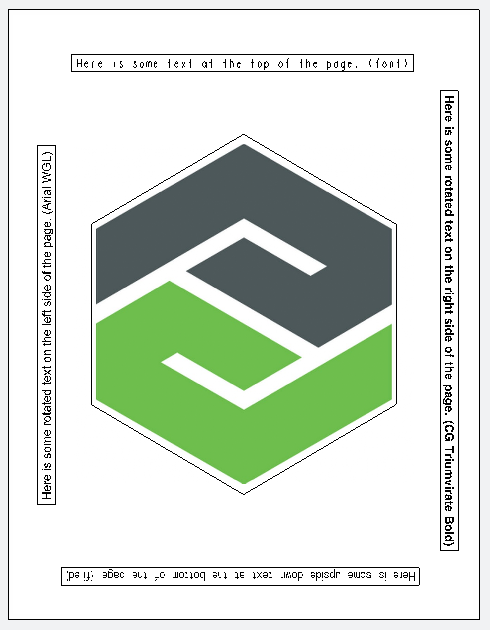

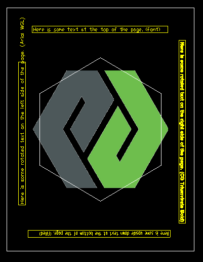

Raphael Nascimento‌, something is very, very wrong with the Postscript output of these images.
Print Preview (and also Save a Copy to PDF)
What the Postscript contains (both output from a color printer and converted to PDF)

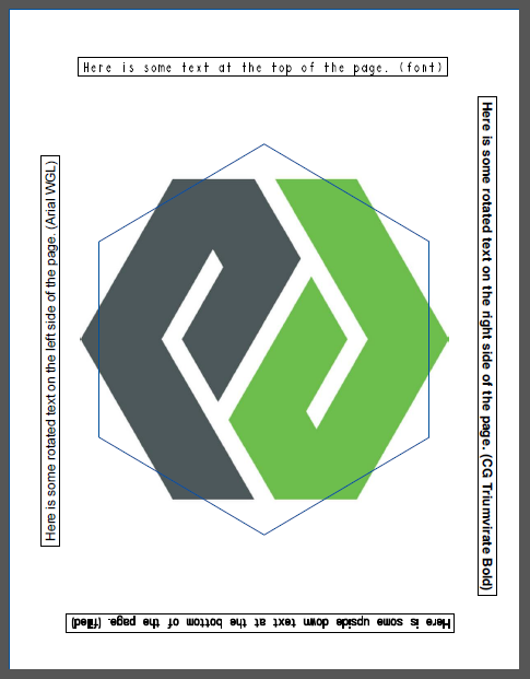

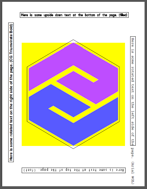

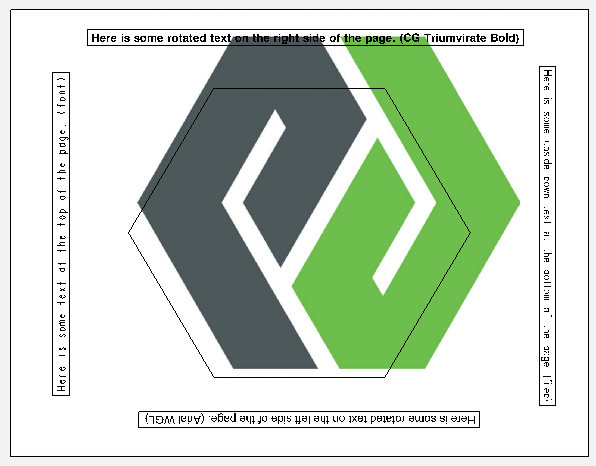

July 26, 2016
There is also a problem with the images and the new "Auto Rotate" printing option.  The image is being rotated and/or resized.
How it's supposed to look:
How it looks with Auto Rotate on and selecting a different orientation:  (wrong size)
There is also some type of "modal" switch that gets flipped behind the scenes causing a similar issue with Save a Copy to PDF:  (rotated)
