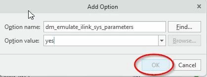

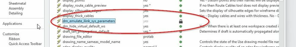

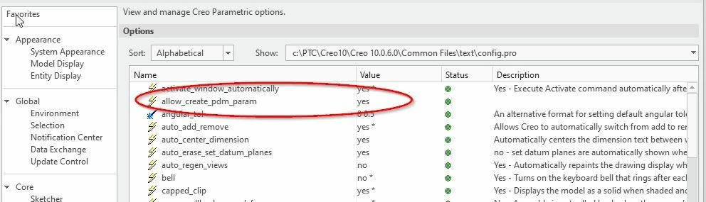

We have Creo10.
I can't find both options in the configuration editor:
  • :dm_emulate_ilink_sys_parameters=yes
  • allow_create_pdm_param=yes
Are those hidden in Creo10?
Chris3
February 11, 2026
Replying to HW_9999718
Yes they are hidden. Put them into your config.pro and then launch Creo and you should be able to modify the parameters
3-Newcomer
February 11, 2026
Replying to Chris3
When I try to add these options, I can't click on OK (it's not activated/still grey)2026-02-11 13_03_40-Creo Parametric Options.jpg

Close Creo, add them to your local config.pro and then restart.
3-Newcomer
February 11, 2026
Replying to Chris3

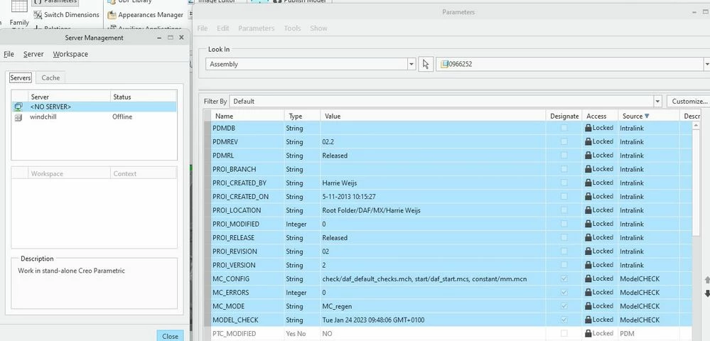

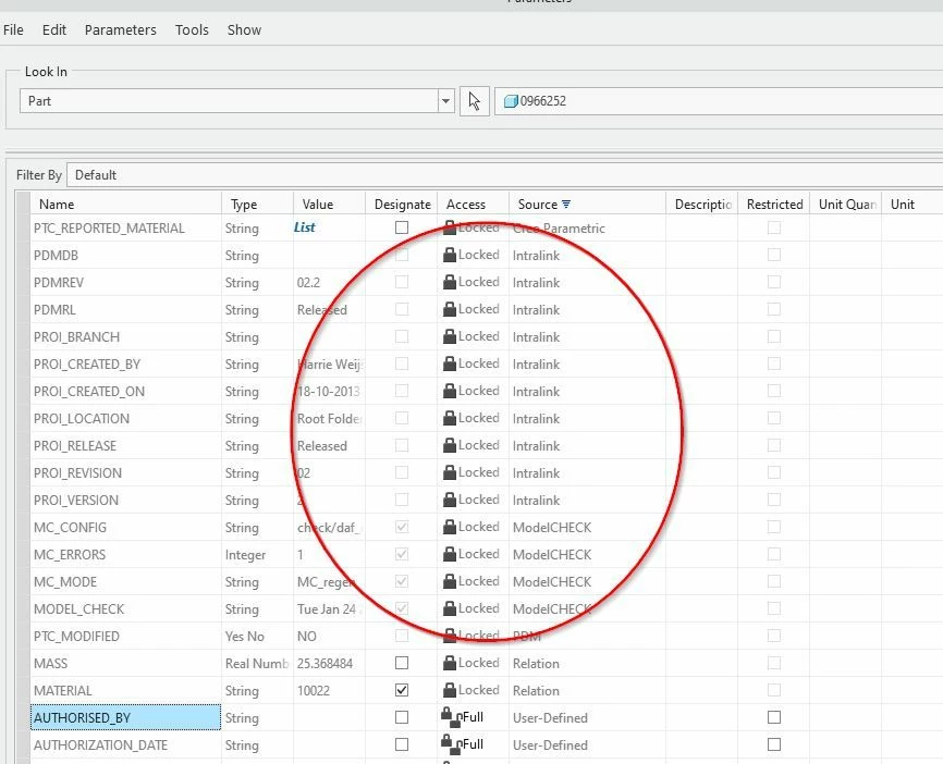

They are now in the config.pro but I still can't remove the Intralink parameters (they are still locked).2026-02-11 13_41_38-Parameters.jpg2026-02-11 13_39_00-Creo Parametric.jpg2026-02-11 13_38_40-Creo Parametric.jpg
Chris3
February 11, 2026
You have to get out of a linked session.
File -> Manage Session -> Server Management -> NO SERVER
Then try
3-Newcomer
February 11, 2026
Chris3
February 11, 2026
Its been a while since I have done this. Try backing it up to a local (ie C: ) drive; verify that you are not in a linked session and then open it from the local drive and see if you can make the change. If that doesn't work try all of these steps:
https://community.ptc.com/t5/System-Administration/Removing-locked-parameters/td-p/1034139
PTC article on this:
https://www.ptc.com/en/support/article/CS105842
