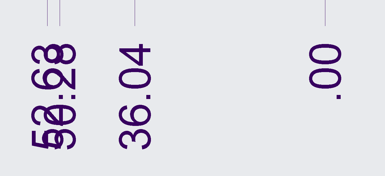

The ordinate dimensions pile up one on top of the other and there isn't a way to clean them up WITHOUT MANUALLY ADDING A JOG.  Cmon people, Cadkey used to clean up its ordinate dimensions automatically... why cant we get this fixed????

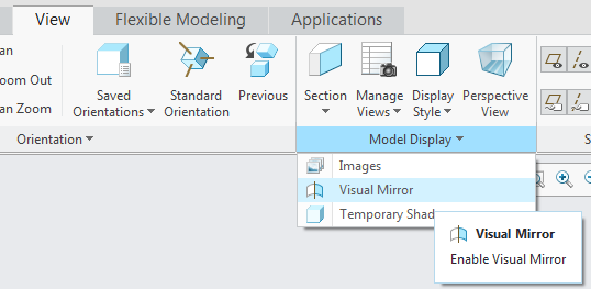

I like the visual mirror though.  that will be handy

Where is this located, in the rendering?
June 23, 2016
Funny I cant find it again.......I thought it was under the view tab under the model display.  Oh  it only works with a part file.
so view/model display/visual mirror.  Alias had this function I used it all the time.
June 23, 2016
Hi Jeff, Dennis,
you can go to View-Scenes-Edit Scene - Environment and turn on Reflection.
Then use display mode Shading with Reflections.
Is that what you where after?
best regards..Martin
June 23, 2016
Martin this is function that allows you to model just one half and still see the mirror of your part.  So you don't have to keep turning on and off a mirror feature.
There isn't a feature here its just a trick with mirrors
