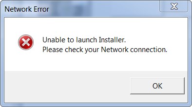

Hello all,
When I try to install from the "pim_installmgr_32.exe" as administrator, this error message appears :
Is it limited to 32 bits machines ?
What is the solution to this trouble ?
