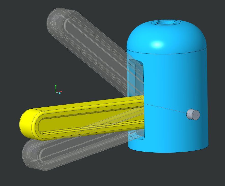

The workflow example  in the below video explains in more detail how you can leverage these (previously discussed) positioning operations  to create a design like this very easily.
he intent here is to drive the cutout of the blue body parametrically based on the defined range of angular movement of the yellow pin. The workflow example makes use of the Flexible Modeling Move feature to create something like a “simplified motion envelope” driving the cutout opening in the blue body.
