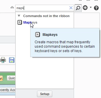

I'm now using Creo2 and I can't find where the button for setting up new
mapkeys is.
I can use searchbox and the mapkey windows opens but how to get it in menus
/ ribbons / buttons ?
Searchlist said that this command is not in the ribbon.
What's the problem ?

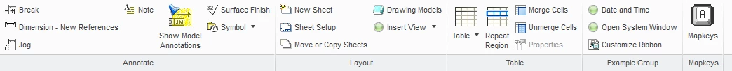

    In Creo 2.0 not only can you customize the ribbon, you can add your own tab, group or cascading selections. In this custom ribbon tab you can then add any of the commands. (Some commands cannot be added to various standard tabs. Like Mapkeys is not a Table function, so you can't add it to the Table tab.)
    Take a look at the attached doc.
    Don

    I was just about to send that, Donald. Also, just a quick way to find buried menus (and, in most cases, also see where they originate.....doesn't help in that regards here....), use the Command Search. Definitely have to hand it to the PTC folks on this one.
    BK
    [cid:image001.png@01CEF4B6.04CCF810]
    Picking then executes the function.

    One also doesn't need to click on the tab to activate it. Just cursoring over the ribbon and using your mouse wheel will advance through the tabs.
    And technically speaking you can make a single custom ribbon tab that has the buttons you use the vast majority of the time right there.
    Taking the Annotate tab for instance, I know I would hardly ever use the icon for: Remove All Jobs, Remove All Breaks, Delete, Draft Group, Relate View, Relate to View, Relate to Object, Unrelate, Ordinate Dimension, Model Datum, Draft Datum, Symmetry Line Axis, Cleanup Dimensions, Attachment, Move to View, Move Special, Move to Sheet, Text Style, Line Style, Arrow Style, Repeat Last Format or Hyperlink. Some of that stuff is simply easier and quicker with the RMB.
    I haven't tested extensively but what I have tested makes it seem like a custom tab doesn't care what command you're trying to use.
    For example, I created this custom tab and the commands seem to operate without complaint, without switching to the proper default tab and without holding the Alt key. I could also move some of the lesser used functions to a group overflow area.
    [cid:image002.png@01CEF4CE.85BD2950]
    Just food for thought.

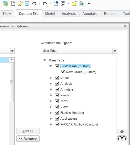

    Yea, I feel for ya. During upgrade here, one of the things I warned was that if you didn't like the Office 2010 tabs, you're in for a rough ride. It would be nice to enable the toolbar customization in addition to the tabs. And sometimes (often?), PTC's view of how things "should" work don't line up with how a huge majority of their actual users actually use it (they definitely have the Apple mentality in that respect). A couple of other quick notes on the customization that we made sure to tell our users (recommended, definitely not a must and arguments go opposite of some of these as well, too!).
    · Stay open and try the default setup first. Then move into customizations (kind of like own a home first and then build a custom home sort of thing).
    · If you make customizations, stick with just creating your own tabs. Leave the default stuff there to just "get used to it".
    · If you do customize existing ribbons/groups, push things to the overflow rather than removing them as removing them impacts the command search.
    · If you do make your own tab, push it all the way to the left so it always opens in that tab (and you can then put the important stuff that you use most of the time).
    [cid:image001.png@01CEF4CB.8CA44F80]==>[cid:image004.png@01CEF4CC.D921A690]
    Subsequent model windows start with that tab active:
    [cid:image005.png@01CEF4CC.D921A690][cid:image006.png@01CEF4CC.D921A690][cid:image007.png@01CEF4CC.D921A690]
