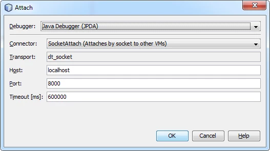

Dear PTC users,
maybe you have an idea how to solve my problem. I am going to develop a synchronous J-Link application in Creo Parametric (but version does not play a role in this case). I just want to compile my project, check if it works, i case of ocurring malfuctions recompile it, checking again, recompiling and so on. but i always have to restart Creo because the new compiled classes are not recognized while running Creo. I also tried to stop and/or unregister my plugin in aux application and restart/reregister it. i also tried to rename my plugin in creotk.dat.
Does anyone know a technique to avoid this?
In last time i always developed asynchronous apps. there you dont have this problem beacuse you can connect and disconnect to/from session each time.

This is all perfectly reasonable, and I had the same problems. Here's
what you can do to resolve it:
1. Learn to attach the Java debugger to your JLink application.
Doing this has many benefits.
2. For simple changes, edit & recompile your JLink application
while the debugger is attached. Java will "hot swap" your
changes into the currently running code.
Hot swapping does not work if you add a new class or make "schema"
changes (new classes, methods or attributes) to your project. It
will really help you out with minor changes, though.

Set this in your config.pro:
jlink_java_command java -Xnoagent -Xdebug -Xrunjdwp:transport=dt_socket,address=8000,server=y,suspend=n
That will allow you to attach the debugger from your IDE. In Netbeans you find it under Debug > Attach debugger...
The dialog looks like this:
[cid:image001.png@01CEB9C4.F357A8E0]
It works in a similar way in Eclipse.
/Bjarne
September 27, 2013
works perfectly fine with netbeans. thanks for your quick response. i also found your presentation. You called it "How to Debug ProENGINEER Applications in Any Language" from PTC World Event 2010
