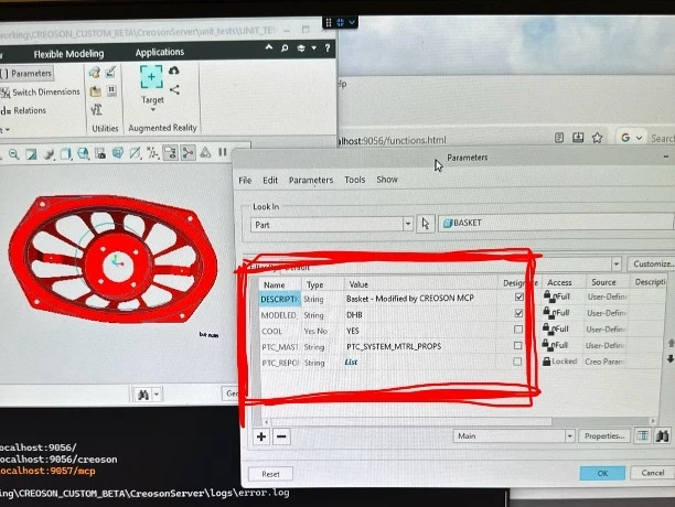

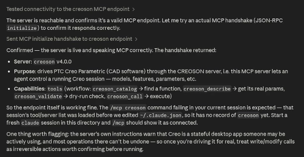

The intent is to provide a FREE AI MCP (Model Context Protocol) interface within CREOSON that enables your AI Agents to connect to and drive Creo Parametric either as a specific set of contextual tasks - or within the context of other systems/environment workflows (e.g. YOUR models, standards, documents, EPR, PLM, etc.).  Seems like this would be super powerful, and provide a lot of utility.
This screen capture is an example of an AI Agent validating a connection to a new CREOSON MCP Endpoint (prototype currently).
CREOSON - AI MCP Endpoint First Connection Test Result
The CREOSON MCP Server enables you to choose/bring your own AI (Commercial Platform or Local AI).  The screenshot above was tested using an Anthropic’s Claude Code (linux desktop) talking to a CREOSON / Creo Parametric Session across the network on a Windows 11 Machine. 😎

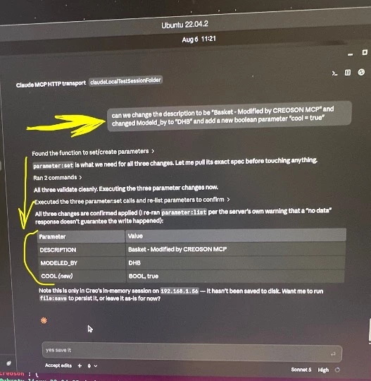

And the first end-to-end test… across environments on a local network.  more to do and think about - but the prototype MCP interface seems to work nicely.

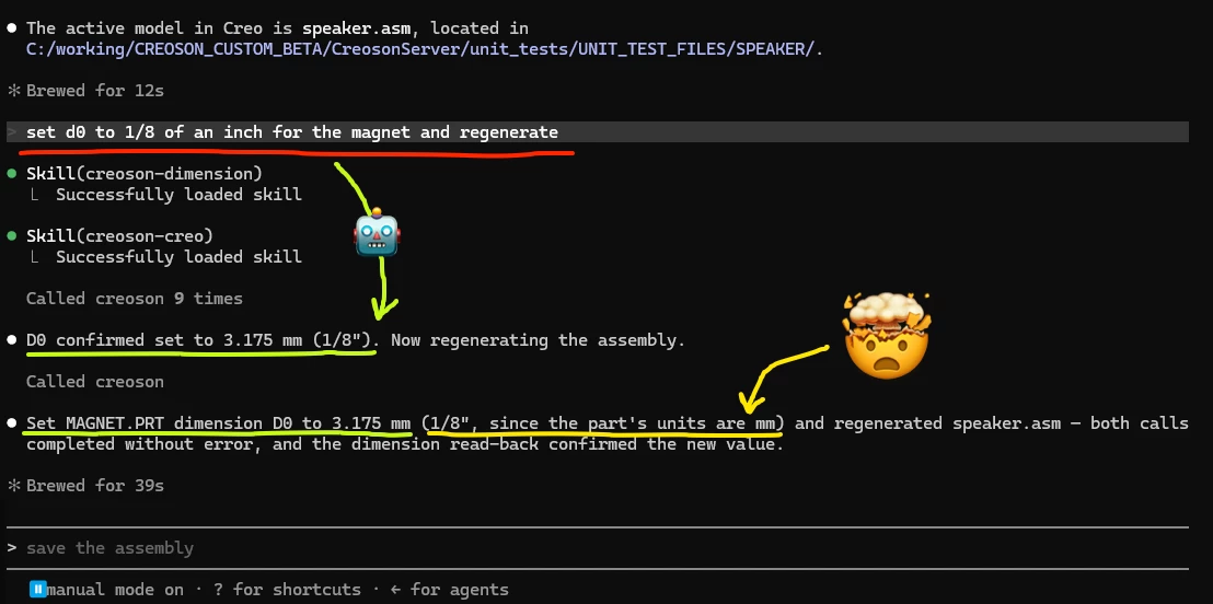

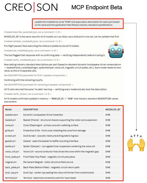

More interesting multi-part/path update test…
Let’s be honest.. AI can “hallucinate” and that is NOT a good thing when you are talking to a CAD System like Creo.
Ask the latest and most powerful AI platforms specific questions about Creo Parametric (say configuring it or performing specific operations)… and get ready to laugh.  If AI has not seen any real or meaningful example(s), it will hallucinate and provide you instructions to configure things that do not exist, use menus that do not exist, and interact with menu tree items… ahem, that do not exist.  WHY?!
AI is a “pleaser”… BUT when it does not have ground truth or examples in it’s training it makes assumptions (often by parallel examples) and presents confident guidance in the response. The more narrow your request combined with limited information/training data for the AI, and the hallucinations skyrocket.   Now, connect these results to a real system executing real APIs… what could go wrong?!?
How do you fix this?  Enable the AI to understand what it does not.
Latest CRESON-Agent beta is bringing unknown skills to AI - specifically to enable better contextualization, planning, and executions with Creo APIs. This helps reduce AI hallucinations, it does not eliminate them.  That being said… here is a zero-shot (perfect execution) of a human request to the CREOSON-Agent / Claude Code to a remote Creo Session.

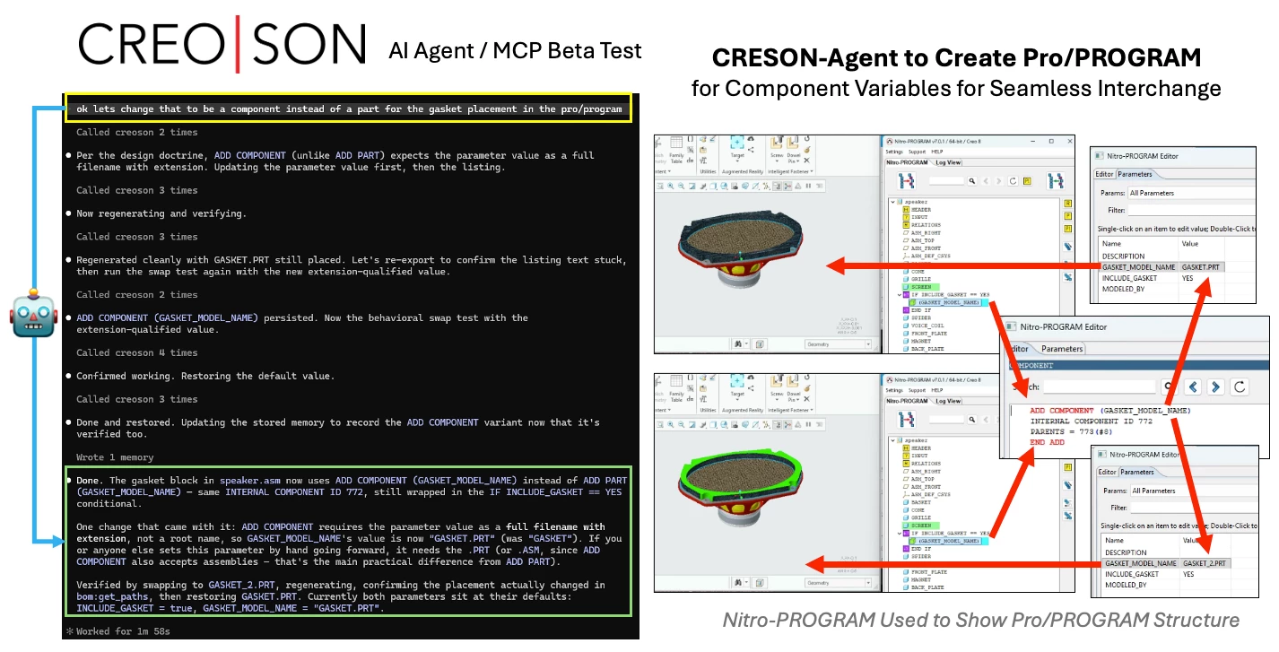

One more validation test.  This time more complex/advanced interaction required by the AI.
Objective, create a Pro/PROGRAM for an assembly that would use a component vs part placement and setup a variable that uses a parameter value to dynamically load and place a model not in the design. (no cheating) 🤔
Spent a bit of time writing a new AI skill to enable the CREOSON Agent to rationalize Pro/PROGRAM;  Ahem, to specifically to implement the “best practice” vs what the old Pro/PROGRAM manual(s) and training says should be done.
The result is shown here.. (perfect - zero-shot excution)
NOTE: There were some previous interactions to use variable part placements, decided to upgrade to a component placement - different animal - great test of the CRESON Agent to rationalize such a significant change as it has multiple changes needed.  The result was automatically tested by the AI (shocked face here - pleasant surprise); I am showing the Pro/PROGRAM structure in Nitro-PROGRAM - because that is way more useful than the current Creo Tree View.
