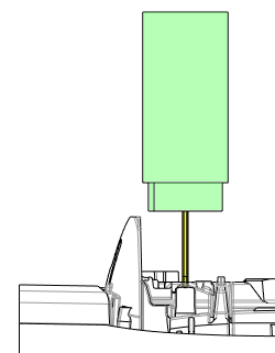

Sometimes small geometries have to be manufactured which create a thin neck if extended to FREE_FACE. The manufacturing of those electrodes is difficult since the blank can break or bend. It's adviseable to add supporting geometry to stablilize the blank.
For example this is disadvantageous:      2016-09-12_020.png
This looks much better:                          2016-09-12_019.png

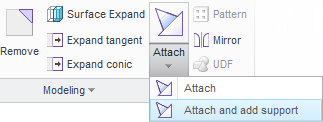

Select "Attach and add support" to connect solid with FREE_FACE.

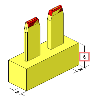

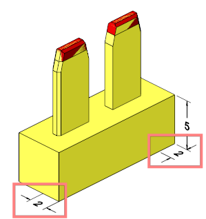

Result
The dimensions of the feature can be adjusted if necessary.

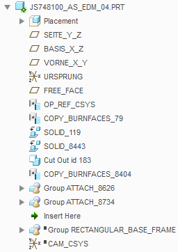

1. Suppress the whole base group in modeltree or move the insert mark in front of the base. 2016-09-12_026.png2016-09-12_027.png
2. Select top surfaces which should be considered for the support. 2016-09-14_003.png
3.
Select "Attach and add support" to connect solid with FREE_FACE. SMARTElectrode recognizes that the solid is already connected to FREE_FACE and adds only the support.
4.
Cancel insert mode.
Result

ATTACH_EXTRUDE_OFFSET Defines the default offset from the boundary of selected surfaces. 2016-09-14_005.png
ATTACH_EXTRUDE_DEPTH
Defines the default depth for the extrusion.
