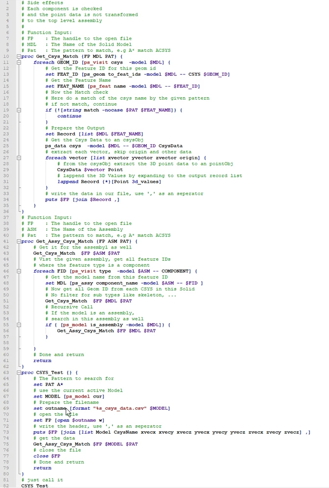

Tcl Code less than 30 lines (in a colored image, after that clear uncolored code) follows, C logic is very similar > 30 lines 😀, even if you use your own filter function
# Side effects
# Each component is checked
# and the point data is not transformed
# to the top level assembly
# Function Input:
# FP	: The handle to the open file
# MDL	: The Name of the Solid Model
# Pat	: The pattern to match, e.g A* match ACSYS
proc Get_Csys_Match {FP MDL PAT} {
	foreach GEOM_ID [ps_visit csys -model $MDL] {
		# Get the Feature ID for this geom id
		set FEAT_ID [ps_geom to_feat_ids -model $MDL -- CSYS $GEOM_ID]
		# Get the Feature Name
		set FEAT_NAME [ps_feat name -model $MDL -- $FEAT_ID]
		# Now the Match check
		# Here do a match of the csys name by the given pattern
		# if not match, continue
		if {![string match -nocase $PAT $FEAT_NAME]} {
			continue
		# Prepare the Output
		set Record [list $MDL $FEAT_NAME]
		# Get the Csys Data to an csysObj
		ps_data csys -model $MDL -- $GEOM_ID CsysData
		# extract each vector, skip origin and other data
		foreach vector [list xvector yvector zvector origin] {
			# from the csysObj extract the 3D point data to an pointObj
			CsysData $vector Point
			# lappend the 3D Values by expanding to the output record list
			lappend Record {*}[Point 3d_values]
		# write the data in our file, use ',' as an seperator
		puts $FP [join $Record ,]
# Function Input:
# ASM	: The Name of the Assembly
proc Get_Assy_Csys_Match {FP ASM PAT} {
	# Get it for the assembyl as well
	Get_Csys_Match	$FP $ASM $PAT
	# Vist the given assembly, get all feature IDs
	# where the feature type is a component
	foreach FID [ps_visit type -model $ASM -- COMPONENT] {
		# Get the model name from this feature ID
		set MDL [ps_assy component_name -model $ASM -- $FID ]
		# Now get all Geom ID from each CSYS in this Solid
		# No filter for sub types like skeleton, ...
		Get_Csys_Match	$FP $MDL $PAT
		# Recursive Call
		# If the model is an assembly,
		# search in this assembly as well
		if { [ps_model is_assembly -model $MDL]} {
			Get_Assy_Csys_Match	$FP $MDL $PAT
	# Done and return
	return
proc CSYS_Test {} {
	# The Pattern to search for
	set PAT	A*
	# use the current active Model
	set MODEL [ps_model cur]
	# Prepare the filename
	set outname [format "%s_csys_data.csv" $MODEL]
	# open the file
	set FP [open $outname w]
	# write the header, use ',' as an seperator
	puts $FP [join [list Model CsysName xvecx xvecy xvecz yvecx yvecy yvecz zvecx zvecy zvecz ovecx ovecy ovecz] ,]
	# get the data
	Get_Assy_Csys_Match $FP $MODEL $PAT
	# close the file
	close $FP
	# Done and return
	return
# just call it
CSYS_Test

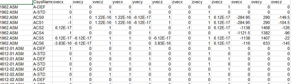

Sample Out
Have fun 😇
