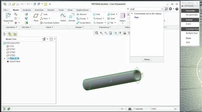

I am trying to read the length of a pipe that is created from a family table.
I read the parameter TOTAL_LENGTH but this gives me the value of the generic pipe and not of the instance.
How can I get the correct value of the pipe length?
Thank you
Regards

Oct 11, 2018 2:07 PM UTC
A few questions:
1) What version of Creo are you running your code in?
2) What sort of Pipe is this? Is this a "Pipe" feature that is created via Pro/PIPING? or a "Pipe Feature"? or is it an Extrude? or are you simply trying to read the value of a parameter in the Family Table?
If you are using a "Pipe Feature":pipe_feat.JPGI haven't tested this myself yet... but I believe you may be able to grab the curves of the Pipe Feature? Worst case scenario, since you know the dimension name, you could always try to find the dimension itself "by name" and read the value from there.
If you are using the Pro/PIPING application:piping.JPGThe only way that I've ever been able to do this "properly" is by using the "ProPNetwork" object in Pro/TOOLKIT. You would visit all the ProPseries (and so on) to be able to find the lengths of all the curves, and add them together.  We use these Piping Objects for many of our Toolkit AutoRouting and Spec-Driven Piping applications.
If it is an Extrude Feature:
You should be able to pull the dimensions or ProCurve feature directly from the model. Use ProFeatureGeomitemVisit to collect the lengths of the curves in the feature.
If you are trying to read the value of the parameter in a Family Table:
One thing to note about working with Family Tables in Pro/TOOLIT: If you are trying to simply read the value of the "Parameter" - then you'll always get the value from the generic.
Instead, you'll need to find the "ProFamtableInstance" for the instance (or "Row") that you want.
From there, find the "ProFamtableItem" (or "Column") that you want (aka the column of the parameter).
Finally, you would use "ProFamtableItemToParameter" to convert this into something useful, so you can read the value of the cell.
Hope this helps!
