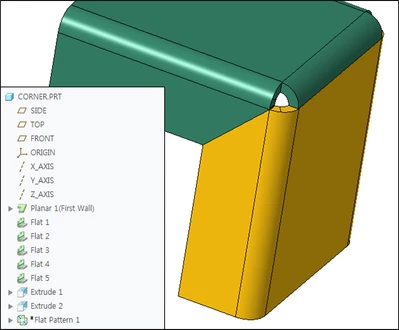

I have a sheet metal geometry as shown.
I am trying to count the number of bends using the toolkit.
Here's how we thought of it:
1. Collect flat, flange, and bend features from the model tree
2. Get vector values of reference planes of collected features
3. Increase the number of horizontal/vertical bends using vector values

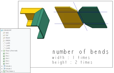

However, the following problems were expected:
Five flat features are visible in the feature tree in the illustration.
When looking at the unfolded shape, the number of bends is 1 horizontally and 2 times vertically.
Any good way to count the number of bends?
Any ideas would be appreciated.

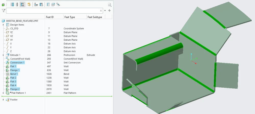

Based on postings from RPN (count cylindrical surface that are from FACE/GREEN sheetmetal side) and GabrielZaha (number of surfaces returned by ProSmtFeatureDevldimsGet()), I implemented both approaches in a single bend-count-function:
Count the number of bends in a sheetmetal model:
- examining only features of type
- Bend (PRO_FEAT_BEND)
- Wall (PRO_FEAT_WALL)
- Smt Conversion (PRO_FEAT_SMT_CONVERSION)
and sum up each feature's bend count.
- For Bend and Wall features, the bend count is the number of surfaces returned by ProSmtFeatureDevldimsGet().
- For Smt Conversion features, the bend count is the number of cylindrical surfaces that belong to the face (green) sheetmetal side (surface property ProSmtSurfType == PRO_SMT_SURF_FACE, via ProSmtSurfaceTypeGet()).
Remarks:
- Only features with status "active" or "active but unregenerated" are being considered.
- This function gives the same result in both sheetmetal states: bended and flattened.
Background:
ProSmtFeatureDevldimsGet() works ootb in both states (bend/flat) and returns the same number of bends.
For Smt Conversion features, the number of child surfaces remain the same in bend/flat state, they only change their in-/active state.
Thus, by examining both the active and inactive surfaces, the relevant cylindrical surfaces can be found and counted as bend (each one).
⚠️Limitations:
Counts only bends of the specified features (BEND, WALL, SMT_CONVERSION). (Support for unknown/new features must be added, if needed.)

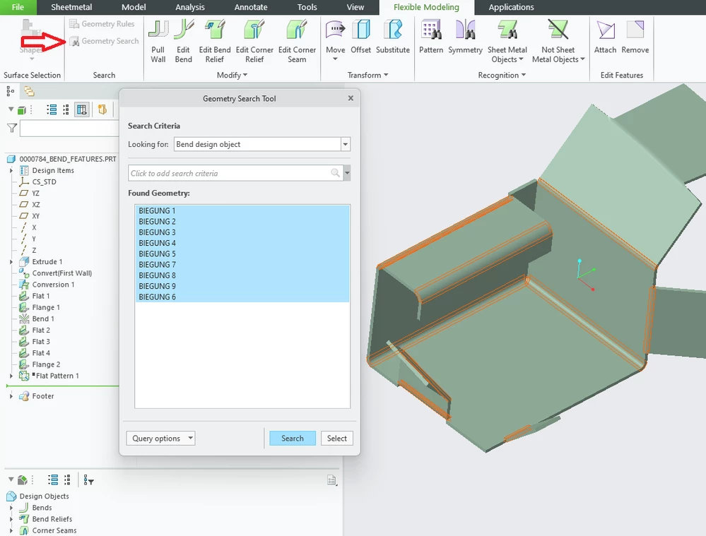

💡 Findings:
For my test case with a bend along a (slightly) curved edge (from a flange feature), this bend-count-function works better than the Creo build-in functionalities 📈 for counting bends:
it does find & count even the curved bend (Creo does not) and counts all other bends correctly.

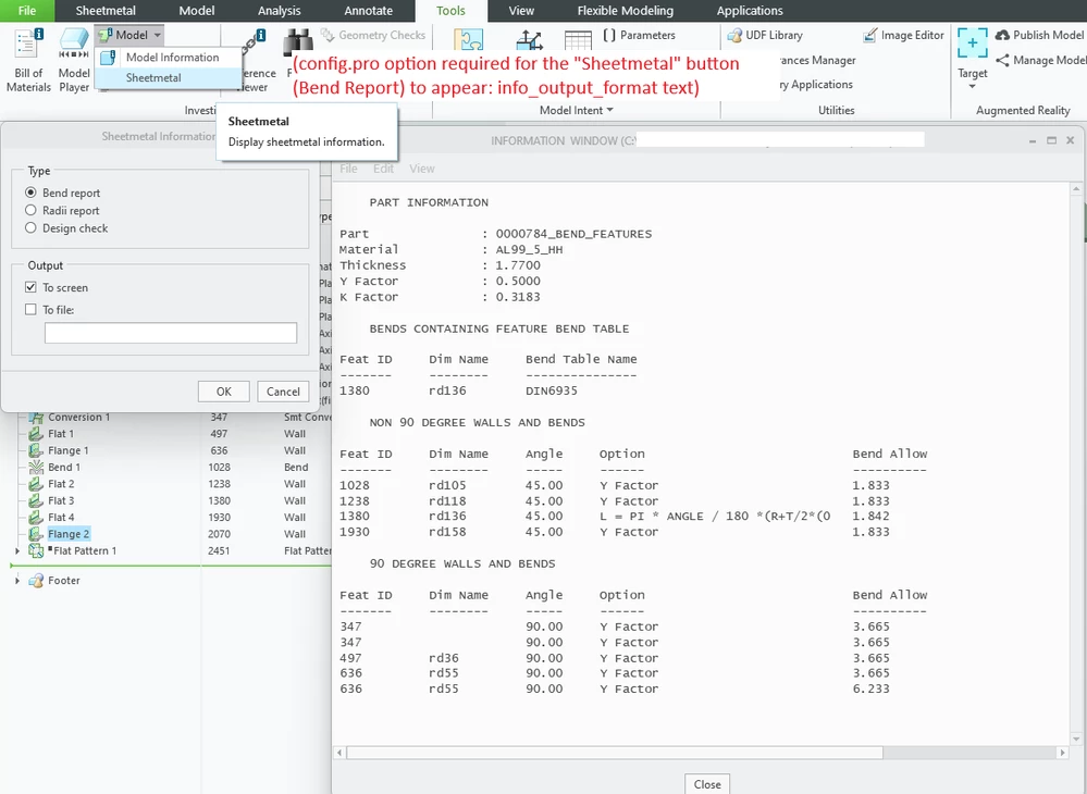

Screenshots of my test case with 10 bends (Creo counted 9, missed the curved edge):
(config.pro option required for the "Sheetmetal" button (Bend Report) to appear: info_output_format text)
