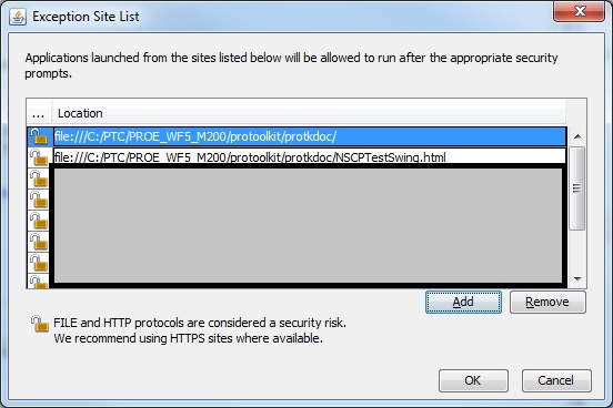

Here is an example of my Pro/TOOLKIT exceptions list.
You must use forward slashes in the path.  I see that you have that in one of your examples.  However, it seems you are missing an additional path/file.
file:///C:/PTC/PROE_WF5_M200/protoolkit/protkdoc/

thanks so much for your reply.
1, I notice that , there is no SPACE in you path. I guess that the SPACE in the path have some affect.
i tried replace the SPACE with '%20', and i will try to copy the doc files to a folder with no SPACE.
2, there are 3 '/' after "file", is it right?
3, do i need to add both 2 locations in your picture to the Exception Site List?
file:///C:/PTC/PROE_WF5_M200/protoolkit/protkdoc/NSCPTestSwing.html
