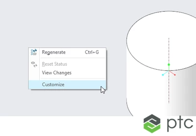

As a disabled user with only one hand, I need a way to setup Creo Parametric to only use Mouse buttons for PAN. This is the only function that I cannot seem to find a work around from Shift + RMB to PAN in my model. Yes, I can use the Pan icon and have been doing that, but it is extra clicks and impacts productivity.
Other CREO PTC applciations have the ability to modify and control the Pan/Zoom/Rotate features (Creo View, Creo Elements etc), Creo Parametric does not have this ability for those of us that need accomidations due to physical disability and limitations.
When will this be fixed for the user community?
June 6, 2025
Hi
It's not perfect but you can have the Pan tool readily available to your RMB you can customize it.
  1. Open a model and RMB (long) in the graphics window: remy_0-1749214413094.png
  2. Select Customize

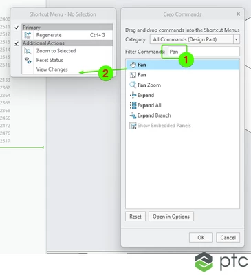

  3. Type "Pan"
  4. Drag it to the menu on the left and add it in the cascade :remy_1-1749214491454.png
To use it :
  1. RMB button on the graphics windows
  2. then select Pan
  3. When you're done MMB to leave the tool
That's setting is then managed with *.ui file.
If you have not already you can go through that article to manage it : https://www.ptc.com/en/support/article/CS288341
