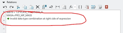

I use creo 11.0.4.0.
In relations  dosnt work formula
MASA=PRO_MP_MASS
errorInvalid data type combination at right side of expression.
What is wrong.
In Creo 7 works perfect.
Regards T

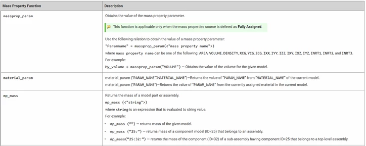

What kind of parameter is MASA? Maybe you can try using MASA=MP_MASS(""), assuming the output should be a string? I'd also recommend putting this relation in post regen to avoid the double regeneration after switching materials.
Creo 11.0 documentation:
RPN

If the RHS (right hand side) of the equation is a double you have to make sure that the LHS has the same type, you can have a miss match if the parameter exist before you have used this one in a relation. Just comment the relation, delete the MASA parameter and finally get rid of the comment.
