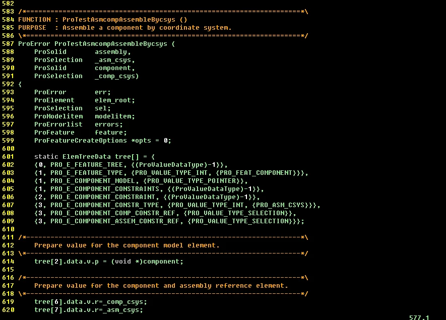

FV_01
Jul 11, 2023 9:33 PM UTC
there is a sample code in protk_appls\pt_examples\pt_asm\TestAsm.c in protoolkit installation folder. Probably this is what you are looking for...
