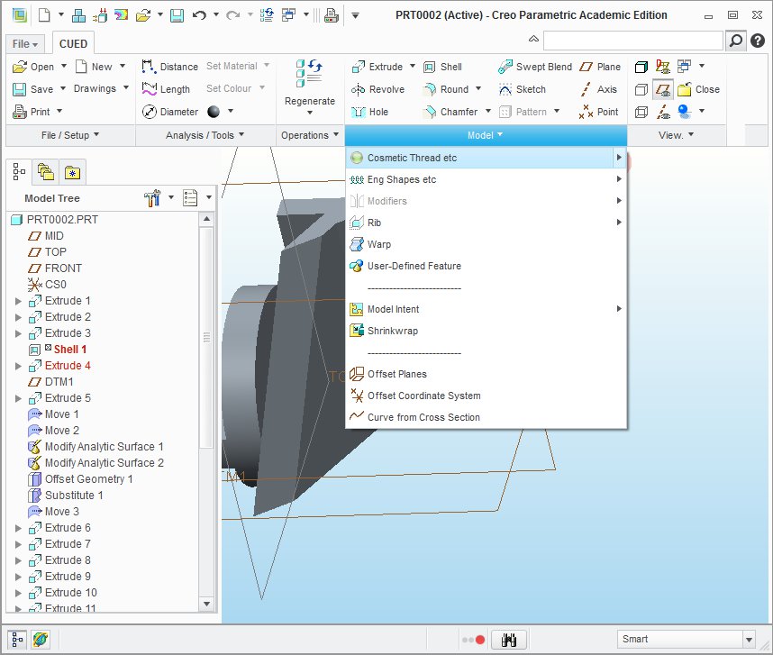

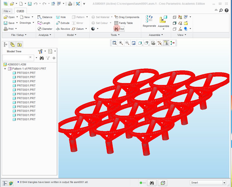

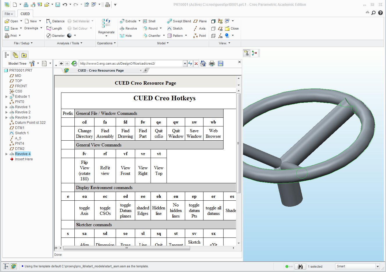

    I am interested in the use of the ribbon especially for casual/non-intensive users
    I teach CREO to classes of upto 100 students at a time, and
    almost to a person they prefer the descriptions rather than the icons, and would also prefer less options visible most of the time.
    Below is the interface we use, currently there is basically only 1 tab in each major area [modelling/drawing/assembly/sheetmetal etc] see the assembly & Part below. This has the benefit that all the main
    functions are visible all the time, [more obscure commands are available by the
    extension menus]. Mapkeys, which are used quite a lot, . do not leave the user in a different tab as seems to the case sometimes on the standard interface.
    Does anyone else use a reasonably highly modified ribbons? If yes do you have any specific tricks that have worked well? If not, have you tried changing them and gone back to the original PTC default?

    Jun 20, 2014 9:31 PM UTC
    Peter,
    Thanks for sharing the screenshots. Wow, that is a pretty dramatic change! Where do users go if they want any features that are normally found in the other tabs?
    Jun 21, 2014 6:32 AM UTC
    The less often features are accessed from the extension pull down menus. As you may be able to see the sections of the ribbon are given the same titles (or sometimes combined titles) as the tabs. In the pull down menus I have tried to combine areas of individual tabs into new cascades and sub-divisions
    Work is still in progress on a new scalable system going from a beginners (sketch-up like interface) -> Normal User -> Advanced. Hopefully the programming paradigm will not be broken in Creo 3.0..
    Regards

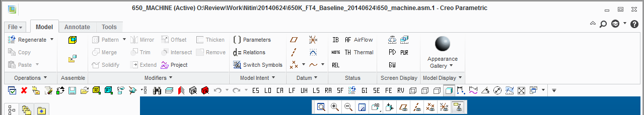

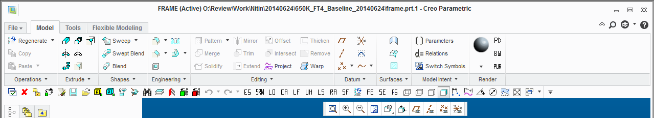

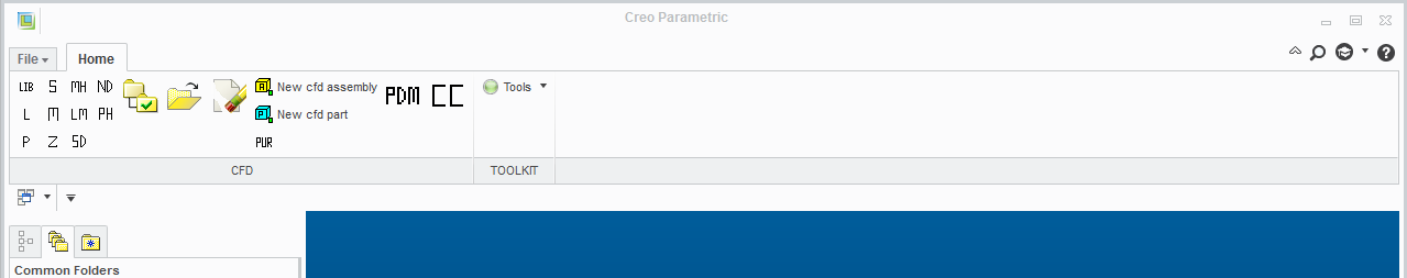

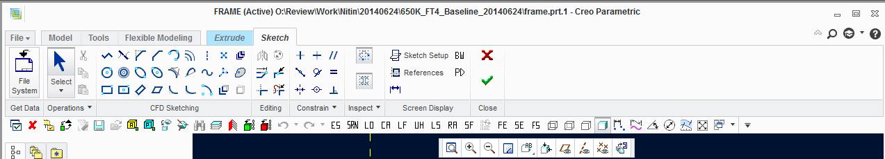

    FYI these are my customized group ribbons we use.
    Startup ribbon:
    Assembly ribbon:
    Part ribbon:
    Sketcher ribbon:
