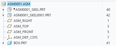

I have multiple skeleton in my assembly. I use to ProAsmSkeletonGet() to retrieve skeleton as ProMdl Skel. It retrieves first skeleton from model. I want to get also the next skeletons to perform operations on feature in it. Can anyone one suggest how do I retrieve second skeleton with help of ProAsmSkeletonGet() or any similar function to perform operation on feature in other skeleton in same assembly.

To get all skeletons, traverse your assembly (only one level or recursively) using ProSolidFeatVisit(): use the following filter function to visit only components that are skeletons:

# Return all active Skeletons by name and the Component/Feature ID
# in the given assembly
# Defaults to Status Active
proc GetSkeletons {Assy} {
  set retData [list]
  foreach {model cid} [ps_visit components -model $Assy] {
    if {[ps_model is_skeleton -model $model] } {
      lappend retData [list $model $cid]
  return $retData
# Call GetSkeletons ASM0001.ASM
# will return
# => retVals {ASM0001_SKEL0001.PRT 42}
# ps_visit components will return
# => ASM0001_SKEL0001.PRT 42 BOX.PRT 41
