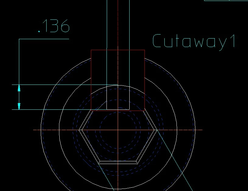

I can't "snap to" or "catch" an intersection when dimensioning.
In this case I would like to dimension from the bottom of a key slot to the top of the shaft at the 12 o'clock position. The only way i have found is to draw a very short vertical geometry line at the point where the center line intersects the diameter line. When I create this line I can snap/catch the intersection of the center line and the diameter line WHY can't I catch the same intersection when dimensioning?
Thank you for your help.
Tim Higdon

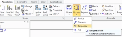

You cannot dimension catching an intersection because a dimension in Modeling is attached to a vertex (the point of the end of an element) or an element.
An intersection is virtual, ie not stored in the file of the drawing.
In your case, use the tangential dimensioning.

Respectfully, I do not agree with this reply. However your reply does highlight the quandary "An intersection is virtual, ie not stored in the file of the drawing". If this is true then why was I able to create a geometry line (in annotation) by snap/catching this virtual intersection of the center line and the diameter line. The reply is not considering/addressing this very important point.
Again my question is why can't I catch the same intersection when dimensioning?
