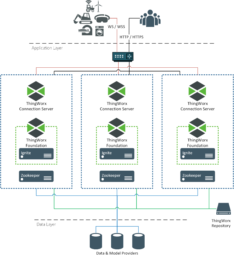

Cost-Efficient Deployment
The first example is deploying ThingWorx in a cost-efficient architecture for smaller or cost-sensitive deployments. Instead of each component on its own separate VM or box, ThingWorx Connection Server, ThingWorx Foundation Server, ZooKeeper, and Ignite are all installed on the same box.
With three boxes in parallel, the system still achieves high availability while reducing deployment costs by minimizing the number of servers utilized. A minimum of three servers is needed to achieve an odd number of instances required by ZooKeeper while still providing redundancy.
In order to optimize for cost while still providing high availability, there are a few factors to consider with this deployment. In this configuration, Ignite is run within the same JVM as ThingWorx Foundation, rather than on a different server. While this does reduce the overall footprint, Ignite will consume additional memory, sharing the resources with the ThingWorx Foundation platform. Since ThingWorx Connection Server is run on the same VM as ThingWorx Foundation Server, this introduces socket limitations, which can restrict the maximum number of connected devices.
In short, the example above illustrates how, while being in an active-active clustered environment, you still retain the deployment flexibility to optimize for your deployment needs. In this scenario, the architecture is optimized for a leaner, more cost-effective deployment at the expense of numbers of connections and memory.

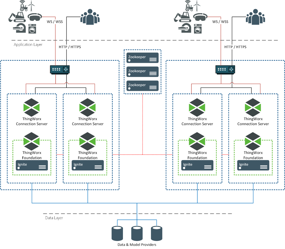

The second example covers how active-active clustering architectural components can be shared across multiple clusters to reduce the cost and complexity of deployment. This can include scenarios where a large deployment spans multiple sites, geographies or end customers.
In this deployment, there are two ThingWorx clusters that share a common ZooKeeper cluster and database layer. Within each cluster, both the Connection Server and ThingWorx Foundation with Ignite running as embedded are deployed on a VM.
For the shared components, proper separation measures must be taken to ensure security. For ZooKeeper, separate namespaces and authentication from the clients are required. For the shared database layer, each cluster must have a unique schema, a separate shared file system and separate user credentials with database-level isolation. Please note that with a large shared database across tenants, rather than a dedicated database for each tenant of HA cluster, there is a risk of impacting performance and availability of other tenants due to issues caused by one of the shared ones.
This architecture is optimized for a larger deployment comprised of multiple ThingWorx clusters requiring separation between the clusters, while still allowing the provider to share a common infrastructure for cost reduction.
