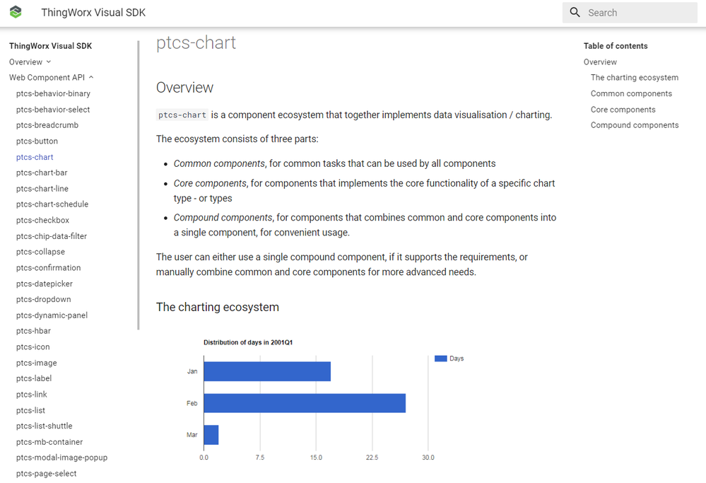

From there, the guide walks you through more setup of your SDK directories, NPM install of PTC components, and basics around dependencies, styling, and demo pages. Each PTC-developed web component is also available in the SDK pages as well with more information on what they offer and their basic designs. This is useful if you would like to reference the PTC components as imports into your own web component. This technique is very useful for re-use and upgrade safety when developing custom components on top of ThingWorx.
imageSample overview pages in the SDK for ptcs-chart

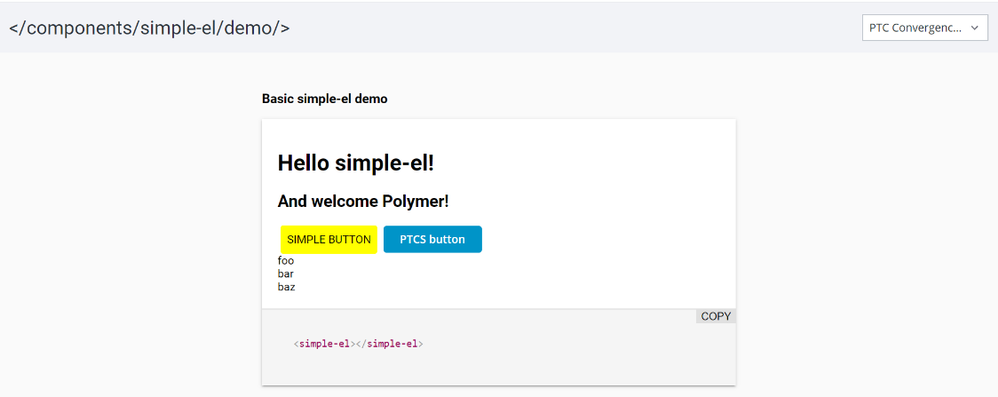

The SDK also includes a getting started tutorial and a sample Polymer component and a widget called simple-el , which are helpful as you want to reference during development and familiarizing yourself with concepts. The component is functional and offers a theme dropdown so you can see how the theming engine and events work.

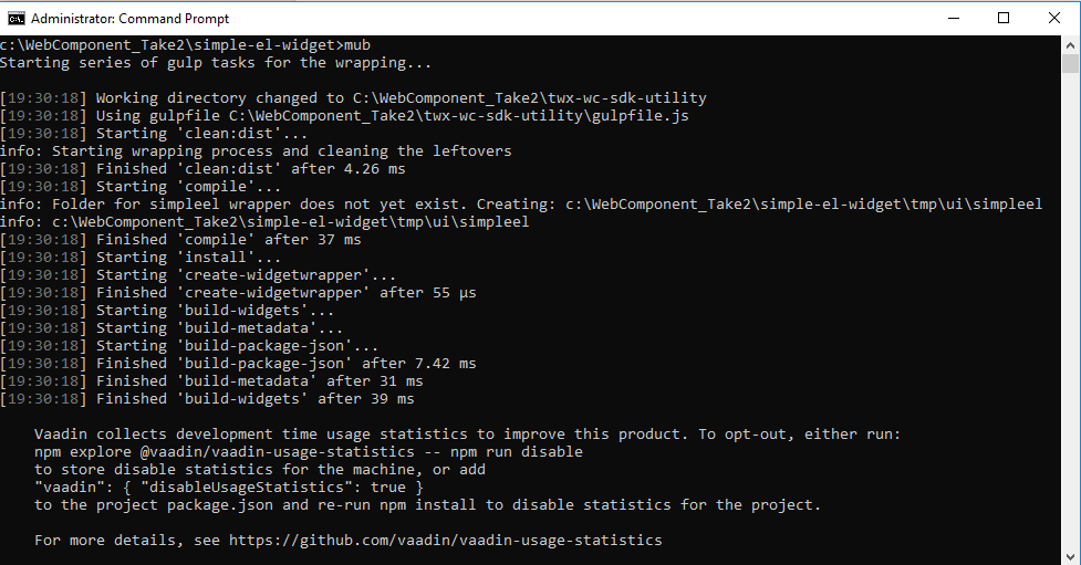

imageSample Polymer component included in the SDK called simple-elOnce you have created your web component, there is also a new utility called mub, which scans your component project and wraps it in a shell for the Mashup Builder. If you run the mub utility on your component, you’ll find it produces a zip file with the relevant design and runtime wrappers for the mashup environment already mapped to your component. You can also use it to define properties for your new component in the mashup environment, include custom code for defining the widgets at design and runtime behaviors, and to add icons, categories and other standard platform features.
imageRunning the mub utility on a web component project

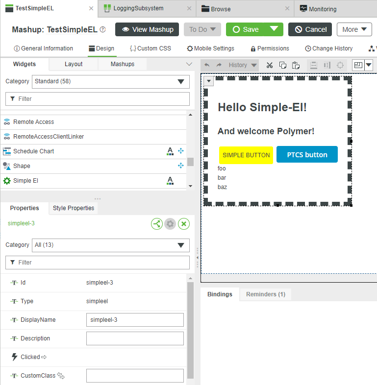

Once you have run the utility, you just import the artifact into a ThingWorx platform and it will be available for your application developers to use in their mashups as a widget. Again, how it appears in the design experience, what properties are exposed, how it responds to platform binding and theming events are all customizable in the SDK.
imageSample Polymer Component wrapped as a widget for use in a Mashup
