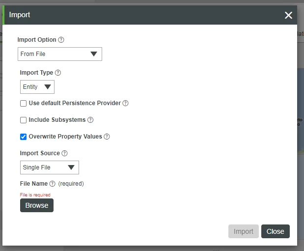

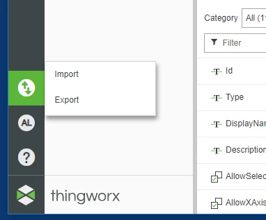

    2. From the Home page of Composer, click the Import/Export icon, then choose Import
    3. Keep the default options and click Browse. Locate and select the CustomCssTutorialMashup.xml file you downloaded and extracted, click Open then Import.

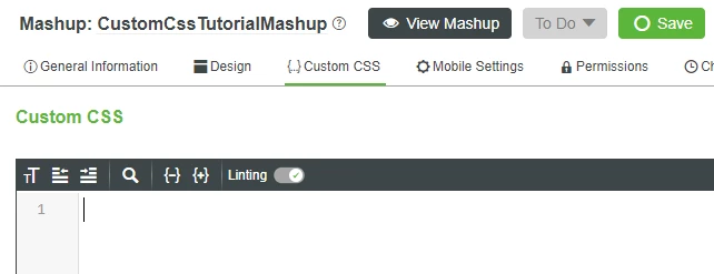

  2. Click Custom CSS.

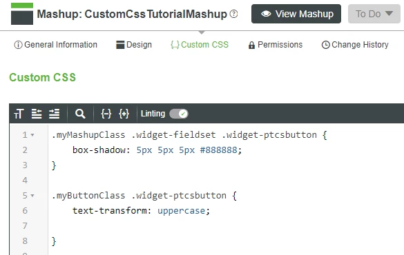

  3. Copy the CSS class below and paste it into the Custom CSS editor:
    .myMashupClass .widget-fieldset .widget-ptcsbutton {
     box-shadow: 5px 5px 5px #888888;
NOTE
: This class will create a shadow around all of the buttons that are in a Fieldset container  only after it is bound to a Mashup,
4. Click Save.

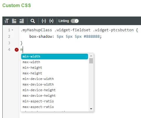

Tips
Press Ctrl -> Space to use the Auto-complete feature and see code snippets, which can expedite your development time.

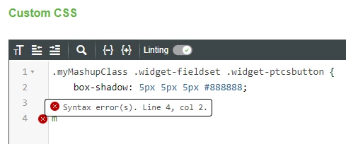

The Linting feature will warn you if there are errors in your code, so you can fix them at design time.

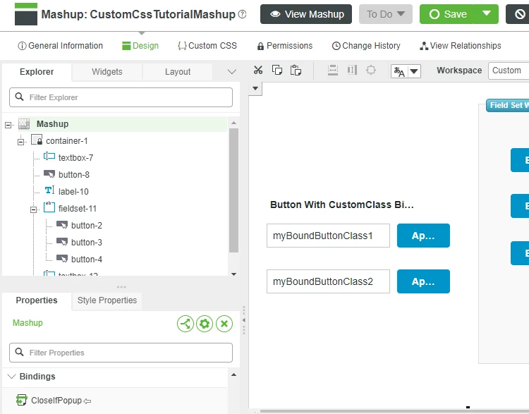

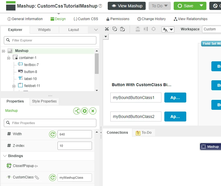

  1. Click Design and select the Explorer tab, then select the top-level Mashup.
  2. In the property panel in the lower left, locate the CustomClass property and type myMashupClass as the value.
  3. Press Tab to save the value change.
WARNING: You must press Tab after every property change in order for the new value to be saved.

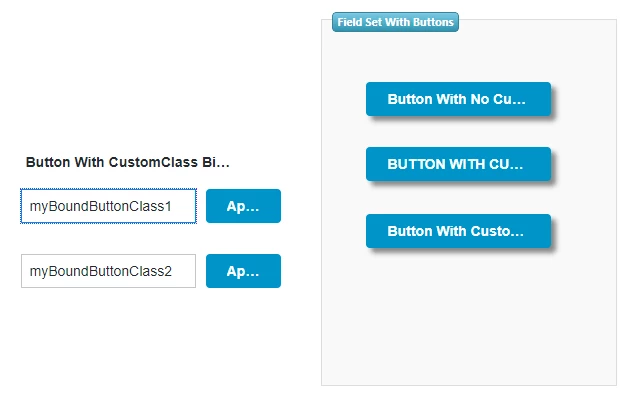

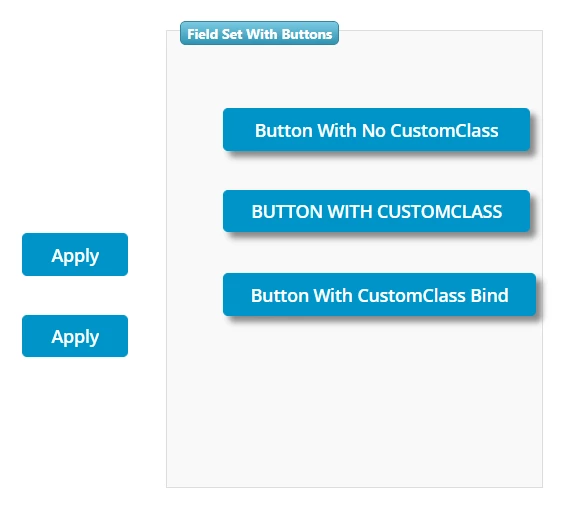

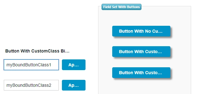

4. Click Save then View Mashup to see that the buttons in the Field Set have shadow borders.

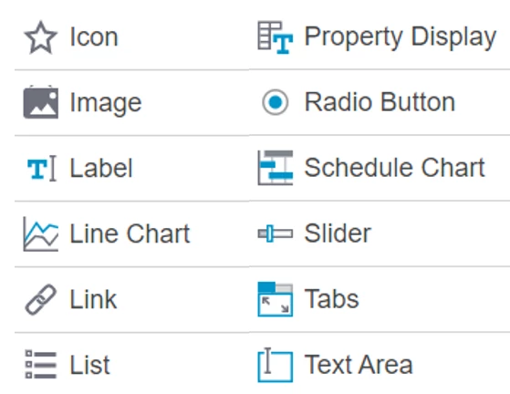

In addition to the Mashup level, you can apply style treatments directly to a Widget in your Mashup. In ThingWorx, the following Widgets have a CustomClass property you can modify:

  1. In the CustomCssTutorialMashup, click Custom CSS.
  2. Add the following css code:
    .myButtonClass .widget-ptcsbutton {
     text-transform: uppercase;

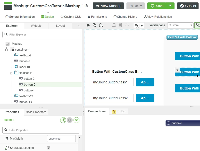

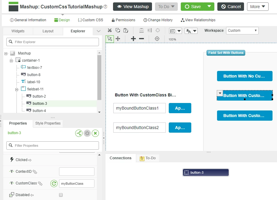

  3. Return to the Design view, and In the Explorer tab, click the button-3.
  4. In the Property panel, enter myMashupClass to the CustomClass field, then press tab
  5. Save then View Mashup the Mashup to see that the button text is now all caps.

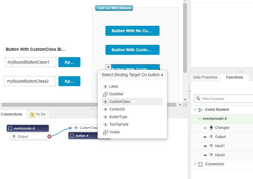

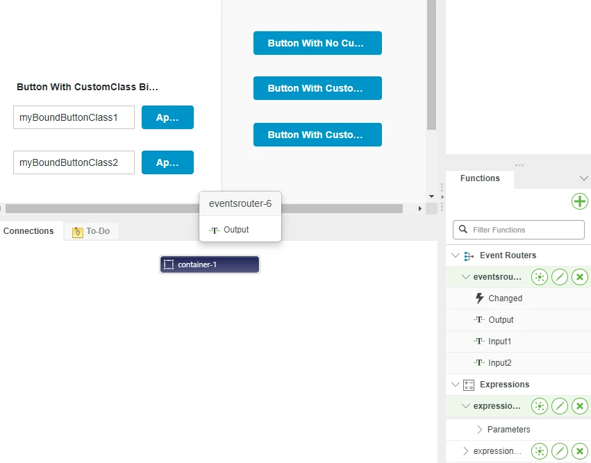

  2. In the Mashup Builder, click the Functions tab in the lower right, then expand Event Routers and expand eventsrouter-6

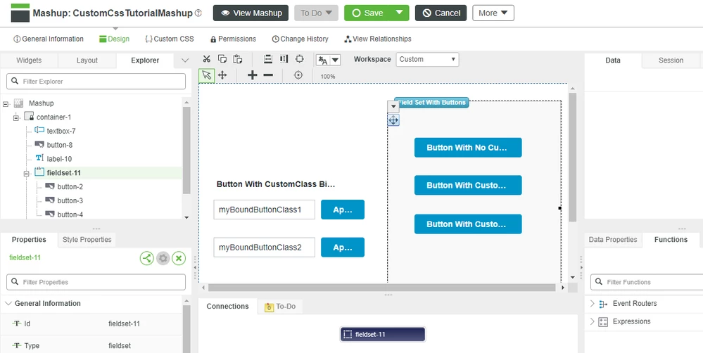

  3. Click Output property and drag it onto the bottom button of the group of three buttons.
  4. Select the CustomClass property from the pop-up to bind it to Button-4

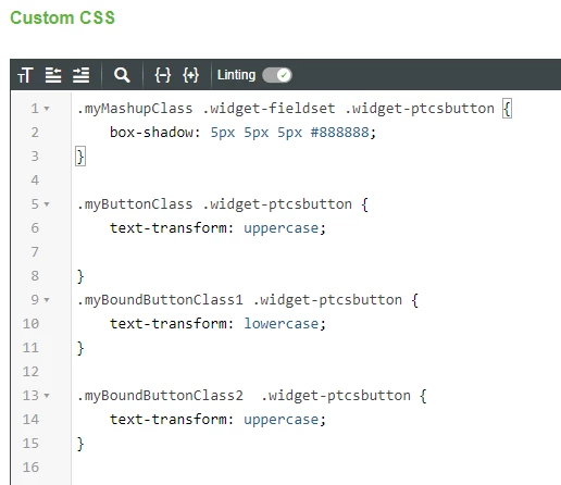

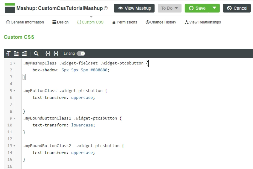

  5. In Mashup Builder click Custom CSS tab.
  6. Add the following css code:
    .myBoundButtonClass1 .widget-ptcsbutton {
     text-transform: lowercase;
    .myBoundButtonClass2 .widget-ptcsbutton {

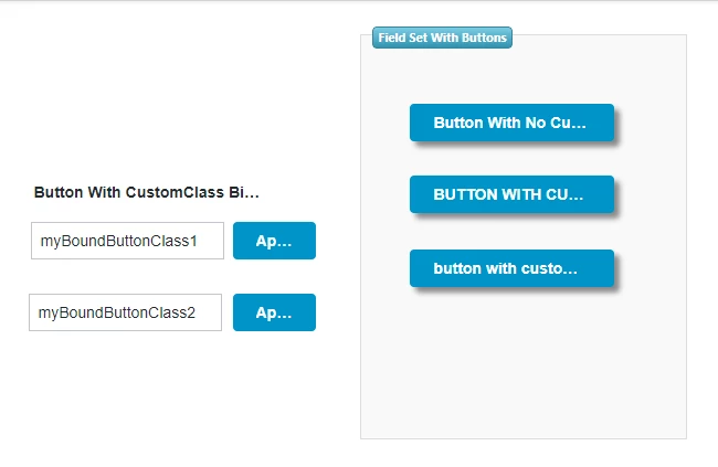

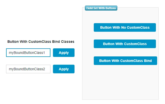

      7. Click Save and then View Mashup.
      8. Click on each of the Apply buttons to see the results of a CSS class applied to in response to user actions.
