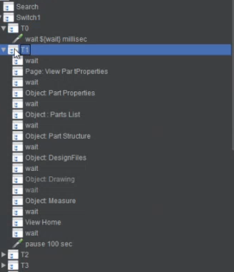

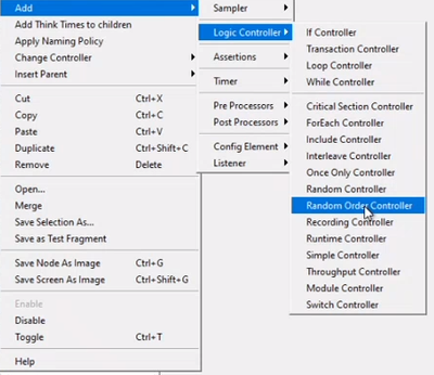

- Use Logic Controllers for Parametrization
Parametrization is critical to mirroring a proper user load, and allowing different data sets to be queried or created; the load should seem organic, random in the right ways, with actions occurring at random times, not predictable times, to prevent seeing artificial peaks of usage that don’t represent real usage of the Foundation server.
- Random order controllers direct the threads down different paths based on random dice rolls, allowing for a randomized collection of user activity each time, not something that has to be regenerated like a set of Boolean values that is specified in an input CSV and used to navigate a series of true or false switches.
- Switches just look for an environment variable to be either 1 or 0, and when it hits a switch that’s a 1, it triggers the switch below, running them in the order given under the transaction controller that goes with the switch.
- In this image, the 1’s and 0’s are given in the CSV input file; randomizing that input file therefore randomizes the execution of the switches too:

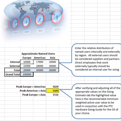

- Concurrency Requirements – How to Properly Estimate the Size of the Load Test
- Take a brand new ThingWorx-based app. How people will be accessing the system and how often? How many are business users? How many are engineers? What do they do?
- Many assume that every named user in the corporate LDAP will need to access to the server, often 10s of thousands of users; this generally drastically oversizes the system.
- Load testing for many thousands of users is very hard and requires a lot of set-up, tuning, and optimization to get right; so if it seems that thousands of users are expected, then validating this claim is important: most customers don’t really have that many concurrent users in an engineering system.
Use estimates based on how many people work at which offices, which time zones those people are in, and what kinds of users they are. Do they need access to engineering data? Perhaps there are simpler mashups for them that uses less resources.
One tool for these sorts of estimations that PTC offers is the office time zone overlap Windchill Sizing Calculator (shown here)
