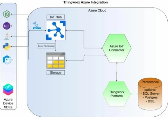

Step 1: Overview Diagram
The ThingWorx Azure IoT Hub Connector 4.0 connects edge devices running agents developed using a Microsoft Azure IoT SDK to the ThingWorx Platform.
The four systems that working together are show in the diagram below:
  • Azure IoT Edge devices
  • Azure IoT Hub
  • ThingWorx Azure IoT Connector
  • ThingWorx Foundation

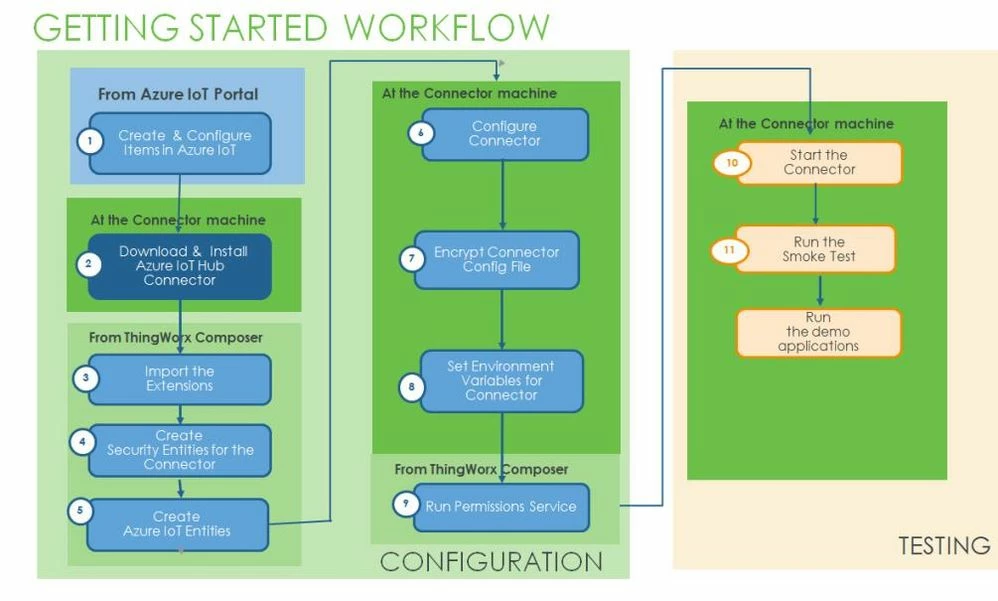

Getting Started Overview
The diagram below shows an overview of the steps for installing and starting the ThingWorx Azure IoT Connector.
The machine where each task is completed is indicated by color.

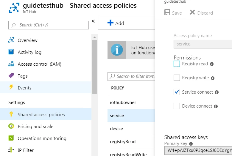

    • consumerPolicyName - Whether you have a new or existing hub, you need to provide the name of the consumer policy and its related Primary or Secondary key. The policy to select is typically the built-in, pre-defined policy called service. Navigate to All Resources > your hub > Settings > Shared access policies > service. If you added a custom service policy to your hub with the permission service connect select that policy.
    • consumerPolicyKey - Once you find the policy name, stay in the Shared access policies screen, and click the name. Copy the content of the Primary key. This key supplies the credentials to access services that are specified in the related policy.

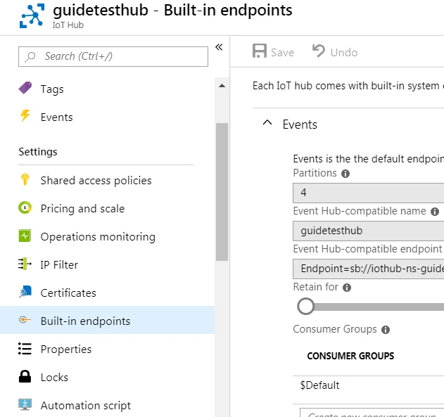

    • eventHubName - The Event Hub-compatible name that is used by SDKs and integrations that expect to read from Event Hubs. An Event Hub is an internal component of an Azure IoT Hub that handles device-to-cloud events for related things. In many cases, the IoT Hub name and Event Hubcompatible name are the same, so this property defaults to the Azure IoT Hub name (hubName). Navigate to All Resources > your hub > Settings > Built-in endpoints > Events > Event Hub-compatible name to find this name.
    • eventHubNamespace - To find the endpoint that is used by SDKs and integrations that expect to read from Event Hubs, navigate to All resources > your hub > Settings > Built-in endpoints > Events > Event Hub-compatible endpoint, and copy the host name, without the rest of the address (".servicebus.windows.net"). The ThingWorx Azure IoT Connector uses this endpoint to read messages from your hub.
    • consumerGroup - To find a consumer group name to enable the Connector to pull data from the Azure IoT Hub, navigate to All Resources > your hub > Messaging > Endpoints > Built-in endpoints > Events > Consumer groups. To use the $Default consumer group, set this property to null.

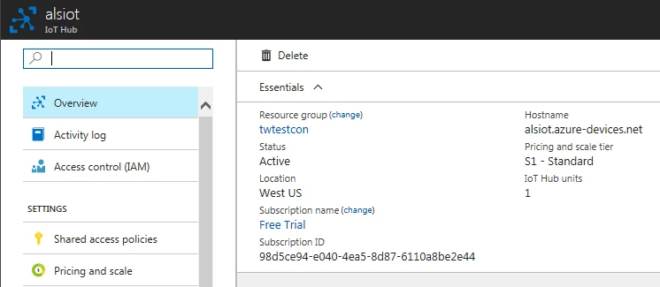

    • hubHostname - To find the host name for your hub, navigate to All Resources > your hub > Overview > Hostname. The host name is defined by the hubName plus a domain name that is chosen by Azure, typically azuredevices.net.

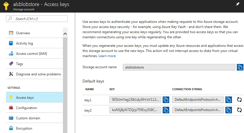

    • blob-storage.account-name - The blob-storage section specifies the settings for an Azure blob storage account. The storage provides containers that are used for device export of an Azure IoT Hub to ThingWorx via the Connector and can also be created by the Connector if you create AzureStorageContainerFileRepository things in ThingWorx. If you do not have one, create a Storage Account in the Azure portal. To find the name of an existing account, navigate to Settings > Access Keys > Storage account name.
    • blob-storage.account-key - The key to associate with the name of the blob storage account. To find the key for an existing account, navigate to Settings > Access Keys > Primary or secondary key.
