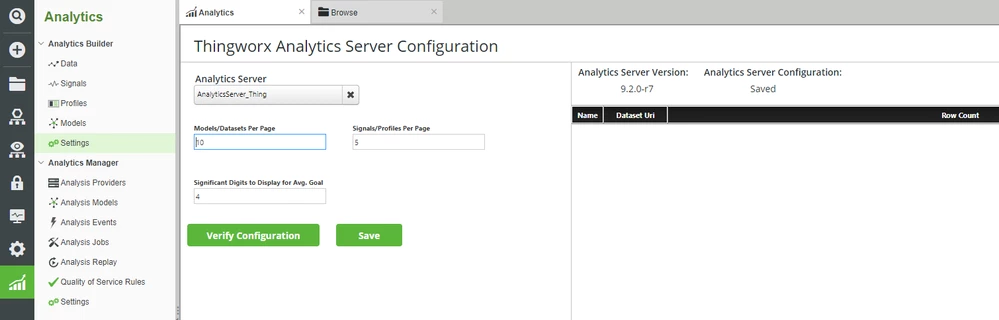

To confirm that Foundation is communicating with Analytics, perform the following steps:

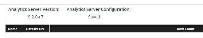

  1. On the ThingWorx Foundation left-side navigation column, click Analytics > Analytics Builder > Settings.
  2. At the top-right in the Analytics Server Version field, ensure that you see an appropriate version number.

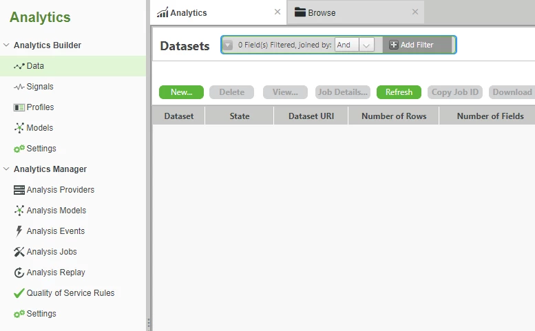

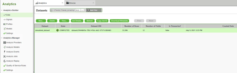

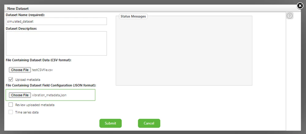

  5. On the left, click Analytics Builder > Data.

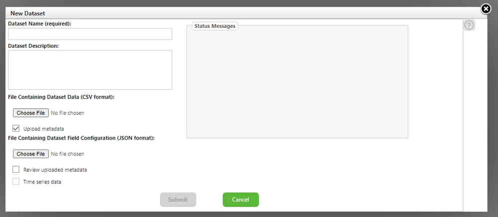

  6. Under Datasets, click New....
  7. In the Dataset Name field, enter simulated_dataset.
  8. In the File Containing Dataset Data section, search for and select testCSVfile.csv.
  9. In the File Containing Dataset Field Configuration section, search for and select vibration_metadata.json.
  10. Click Submit.
    • Note that the time it takes to import the dataset is determined by its size.

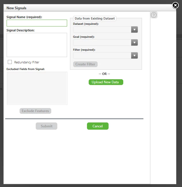

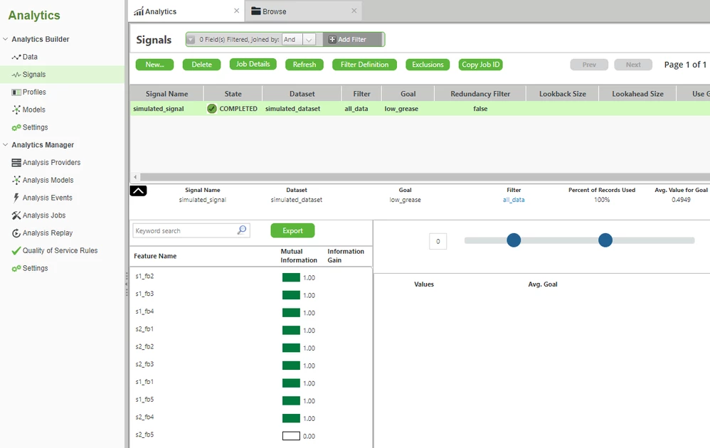

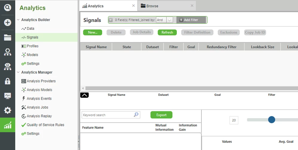

The Signals section of ThingWorx Analytics looks for the most statistically correlated single field in the dataset which relates to your selected goal.
This doesn't necessarily indicate that it is the cause of your goal, whether maximizing or minimizing. It just means that the dataset indicates that this single field happens to correlate with the goal that you desire.

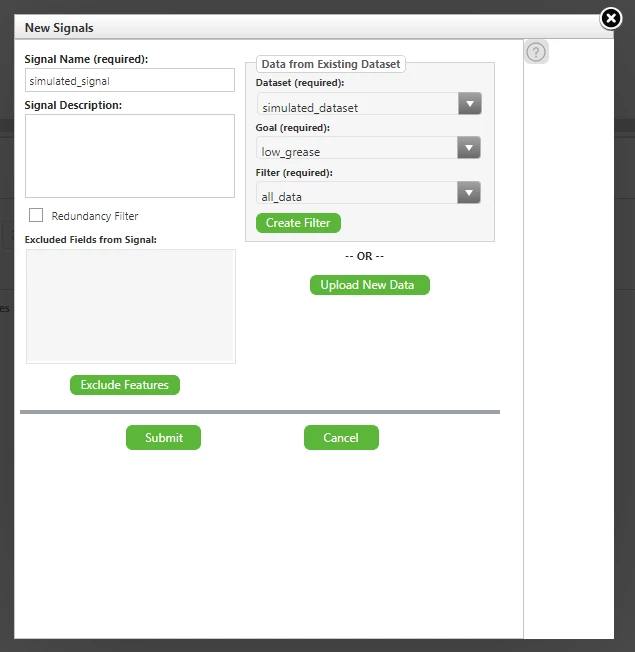

  1. On the left, click Analytics Builder > Signals.
  2. At the top, click New….
  3. In the Signal Name field, enter simulated_signal.
  4. In the Dataset field, select simulated_dataset.
  5. Click Submit.
    • Wait ~30 seconds for Signal State to change to COMPLETED
Unfortunately, our results aren't very good. Or, more accurately, they're too good.
Our simulated dataset has some noise in it from adding random values to our five frequency bands on each our two sensors. However, ThingWorx Analytics has instantly seen through that noise and discarded it. Instead, it's only detected that s2_fb5 isn't relevant.
If you look back at the Use the EMS to Create an Engine Simulator guide, you'll see that s2_fb5 has the same base value between both a "good grease" and a "bad grease" condition, i.e. a base of 190.
This does show already that Analytics is working, though. Since s2_fb5 didn't change between good and bad grease conditions, our Signal analysis is indicating that it's not relevant to our model.

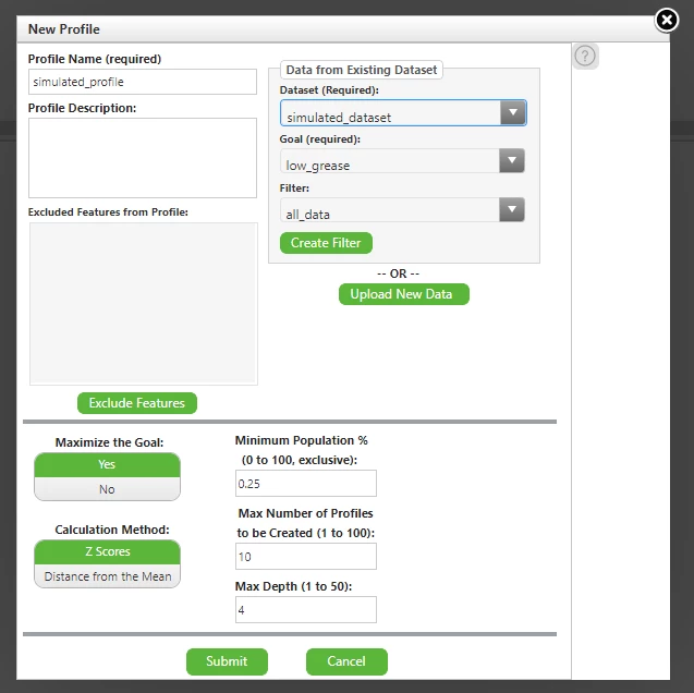

Profiles

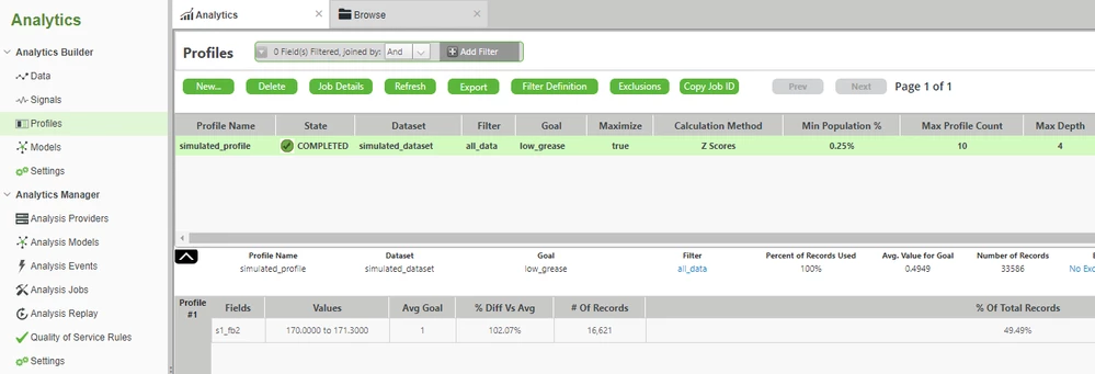

Now, let's do the same for a Profile.

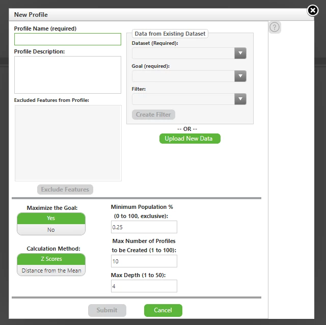

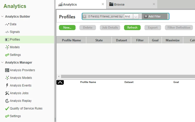

The Profiles section of ThingWorx Analytics looks for combinations of data which are highly correlated with your desired goal.
  1. On the left, click Analytics Builder > Profiles.
  2. Click New....
  3. In the Profile Name field, enter simulated_profile.
  5. Click Submit.
    • Wait ~30 seconds for the Profile State to change to COMPLETED.
Just like with Signals, our Profile is too good. In fact, Analytics is indicating that just s1_fb2 by itself is the primary indicator of good vs. bad grease conditions.
This is likely due to random chance. The random noise added to s1_fb2 just happened to be slightly less than the other frequency bands, so everything else was discarded.
Regardless, ThingWorx Analytics is quickly seeing through our simulated data.
