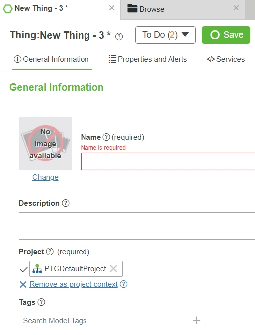

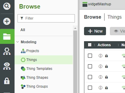

  1. In ThingWorx Foundation, navigate to Browse > Modeling > Things.
  2. Click + New.

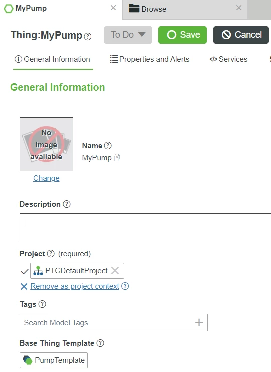

  3. In the Name field, type MyPump.
NOTE: This name, with matching capitalization, is required for the data display created in a later step.
      4. If Project is not already set, click the + in the Project text box and select the PTCDefaultProject.
      5. In the Base Thing Template field, search for and select the previously-created PumpTemplate.
      6. At the top, click Save.

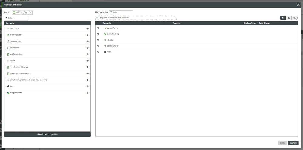

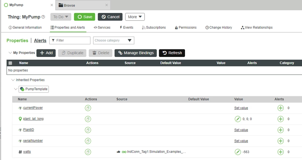

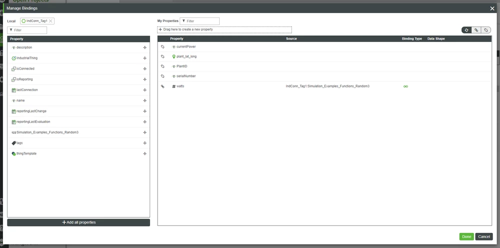

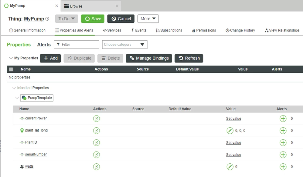

Manage Property Bindings
  1. At the top, click Properties and Alerts.

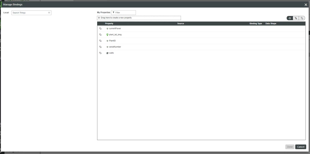

  2. At the top, click Manage Bindings.
  3. In the top-left Local > Search Things field, search for and select IndConn_Tag1.
  4. Drag-and-drop Simulation_Examples_Functions_Random3's + symbol onto the watts Property on the right.
  5. At the bottom-right of the pop-up, click Done.
    • Note how the Tag from ThingWorx Kepware Server is now bound to the the watts Property.
  6. Click Save.
  7. Click Refresh repeatedly to confirm the watts Property value is changing.IoTProductMgmt_7-1658973567620.png

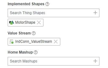

Now that you have created the MyPump Thing to model your application in ThingWorx, you need a storage Entity to record changing Property values. This step shows how to save time-series data in a Value Stream already created in a previous guide. To learn more, refer to the Methods for Data Storage guide.

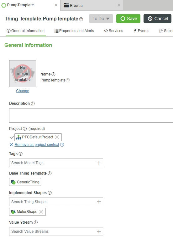

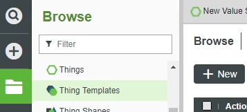

  1. Navigate to Browse > Modeling > Thing Templates.
  2. Click the previously-created PumpTemplate Thing Template to open it.
  3. Confirm you are on the General Information tab.
    • If necessary, click Edit to allow changes.

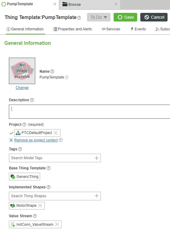

  4. In the Value Stream field, search for and select IndConn_ValueStream.
  5. Click Save.

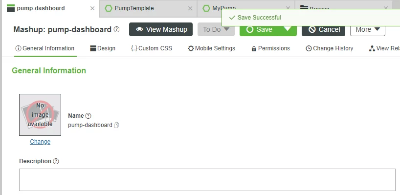

Create New Mashup

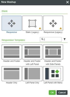

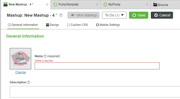

  1. Navigate to Browse > Visualization > Mashups.
  2. Click + New.
  3. Keep the defaults and click OK.
  4. In the Name field, type pump-dashboard.
  5. If Project is not already set, click the + in the Project text box and select the PTCDefaultProject.
  6. Click Save.

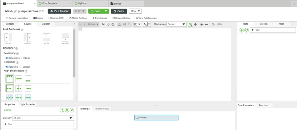

  7. At the top, click Design.

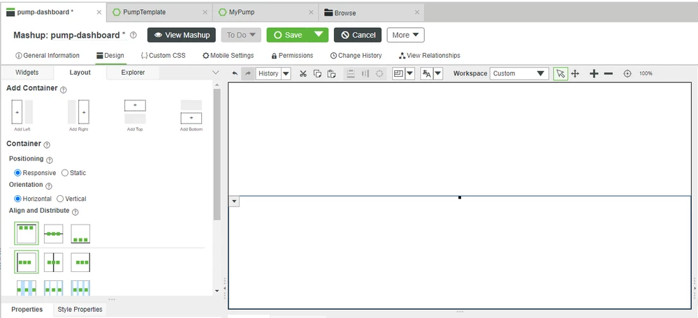

Define Mashup Areas

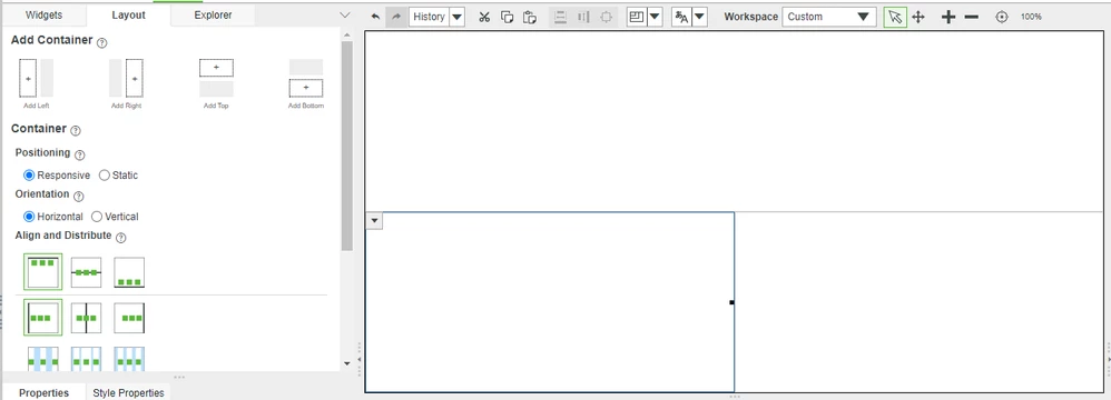

  1. At the top-left, ensure the Layout tab is selected.
  2. Click Add Bottom to split your UI into two halves.
  3. Click the newly-created bottom-half to select it.
  4. Click Add Left.

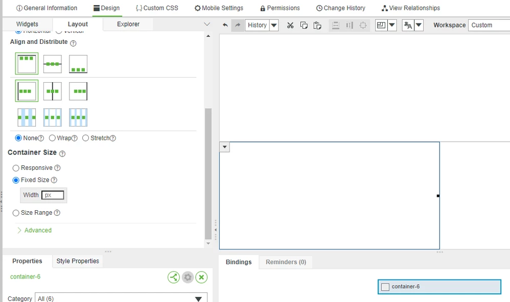

  5. Click the bottom-left container to select it.

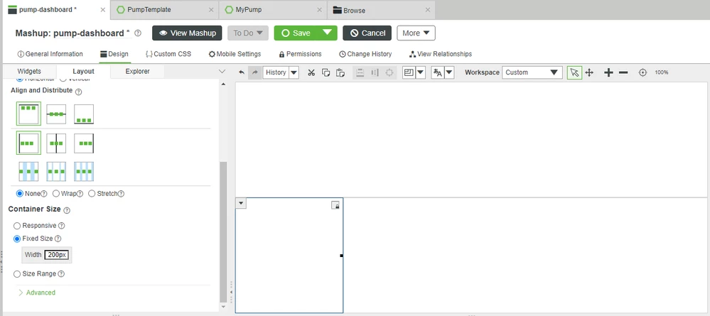

  6. In the top-left Layout section, scroll down and select Fixed Size.
  7. Type 200 in the Width text box that appeared, then press your keyboard’s Tab key to record your entry.

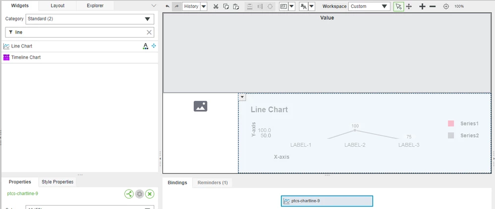

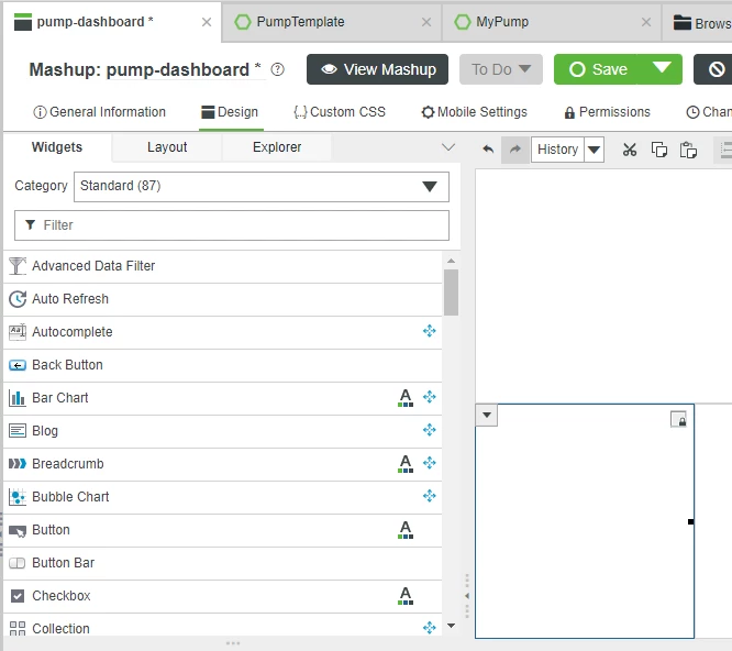

Add Widgets

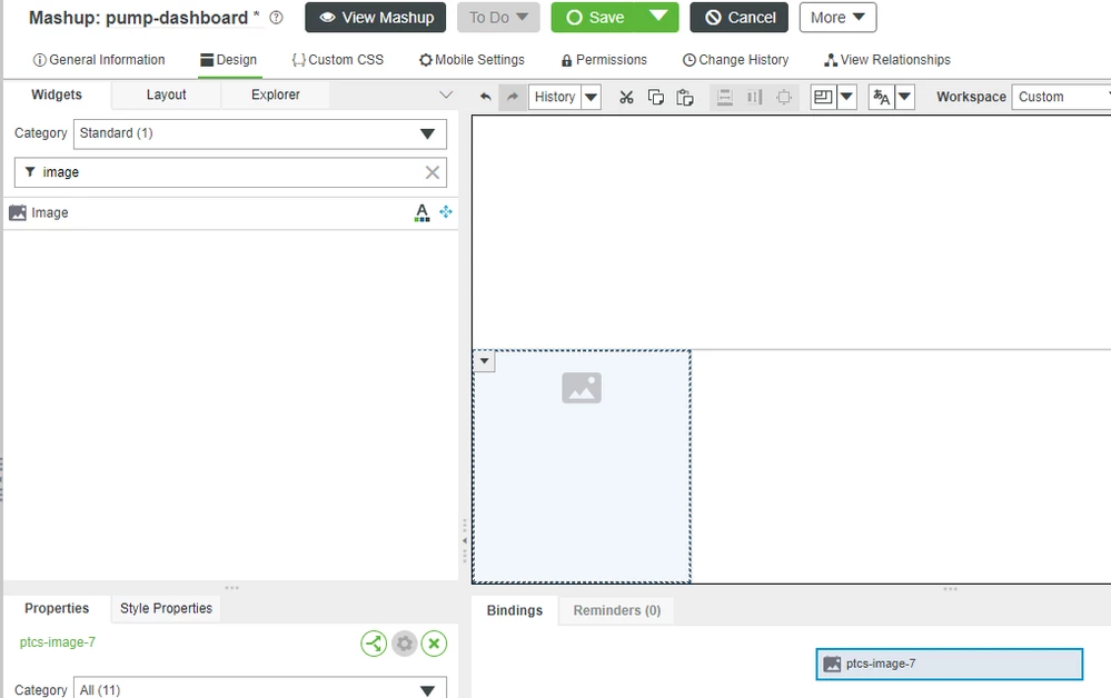

  1. In the top-left, click the Widgets tab.

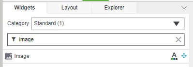

  2. In the Filter field, type image.
  3. Drag-and-drop an Image Widget onto the lower-left area of the central Canvas.
    • This Widget will show an image of the pump in use.

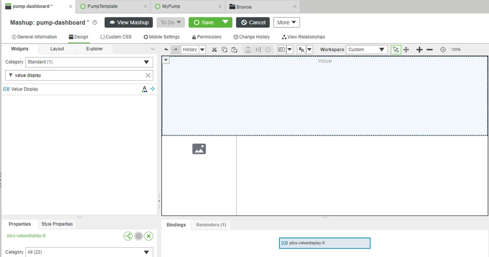

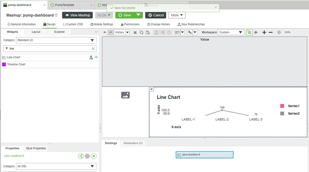

4. In a similar manner to what was just done with the Image Widget, drag-and-drop a Value Display Widget onto the top area.
5. Likewise, drag-and-drop a Line Chart Widget onto the lower-right area.
6. Click Save.
