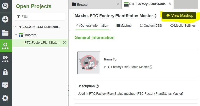

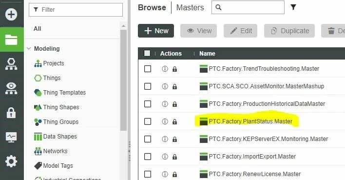

  1. In ThingWorx Foundation Composer, click Browse then Visualization > Master then click PTC.Factory.PlantStatus.Master.
     2. Next click the View Mashup button.

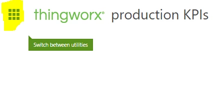

   3. Click the Utility Selector grid in the upper left
   4. Click Trending and Troubleshooting

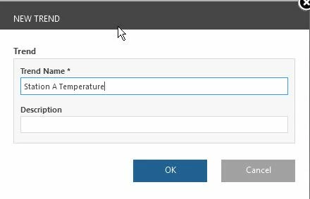

            NOTE : A New Trend pop-up will appear.

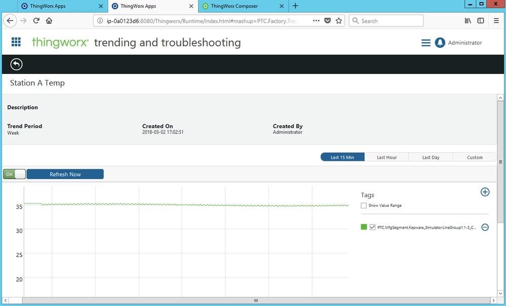

     6. In the Trend Name text box, type Station A Temperature, then click OK.

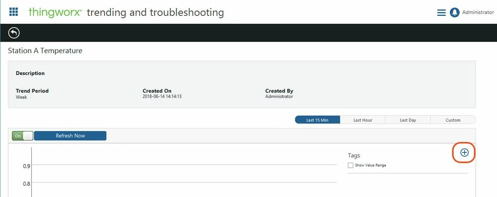

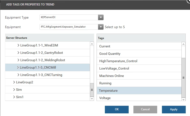

    7. In the Tags area, click the + icon to start plotting a tag
   8. In the Equipment Type drop-down, choose KEPServerEX, in the Equipment drop-down,
       choose your KEPServer or the simulation server.
9. In the Server Structure menu, click LineGroup1 and use the drop-down menu to select LineGroup1.1-3_CNCMill. In the Tags menu area, click Temperature then click OK, or choose a tag based on your KepServer configuration.

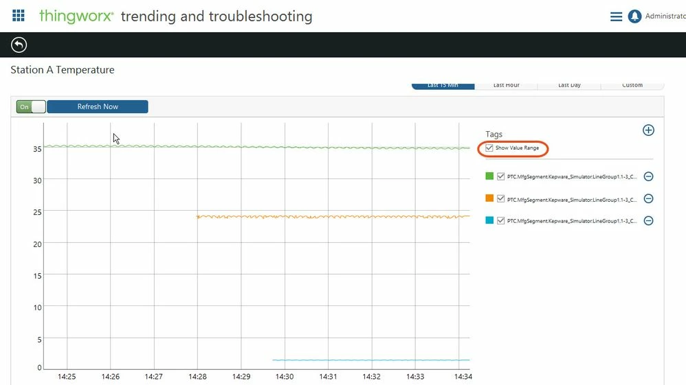

10. Review the trend data for Station A.
11.  Repeat these steps to apply additional property setting to Station A.
12. Check the Show Value Range box in the Tags area. Review the trend data for the properties selected.
               NOTE: The three selected tags will appear plotted in the Show Value Range table.
