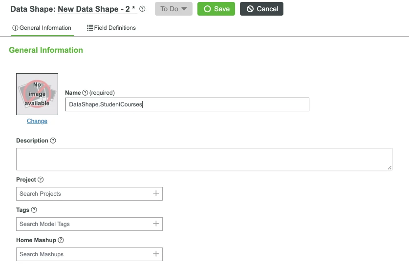

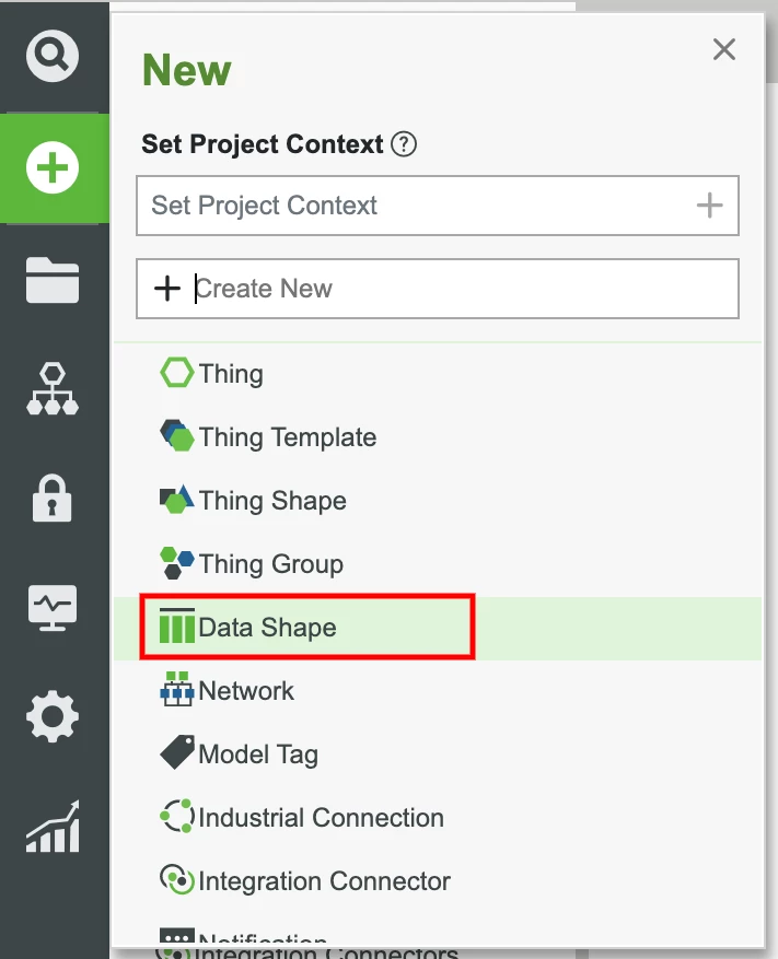

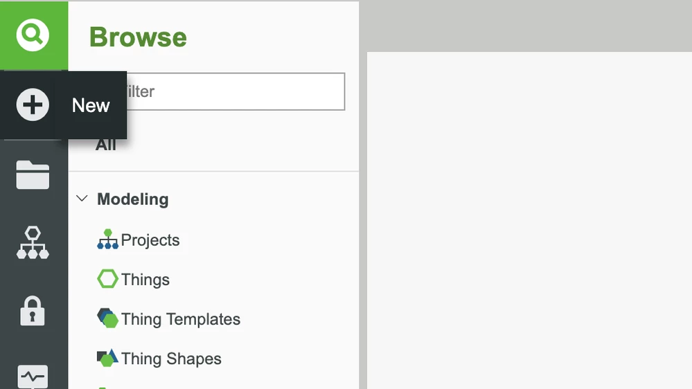

1. In the ThingWorx Composer, click the + New button in the top left.
2. In the dropdown list, click Data Shapes.
3. Name the Data Shape DataShape.StudentCourses
4. Add the set of fields below. You may notice, we included information from the Person table that we might already have. This is perfectly fine based on how much data you expect to come back. This will allow you to reuse this database for other purposes later where the person information might change. This can be very beneficial when you're calling a service with this Data Shape (or InfoTable based on this Data Shape). Allowing you to keep the input simple.
NameBase Type Additional Info
 id STRINGPrimary Key
 person_key STRING N/A
 person_name_first STRING N/A
 person_name_last STRING N/A
 course_key STRING N/A
 course_name STRING N/A
 course_professor STRING N/A

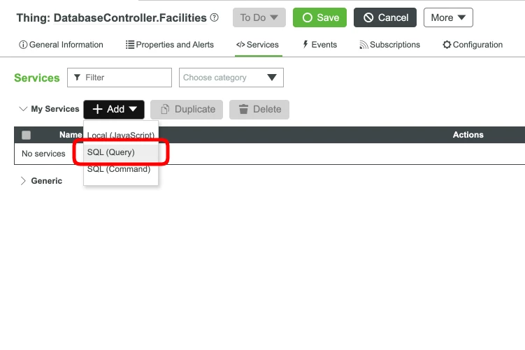

1. Open the DatabaseController.Facilities entity and go to the Services tab. If you have not done so as yet, add the configuration information to allow your queries to connect to a database.

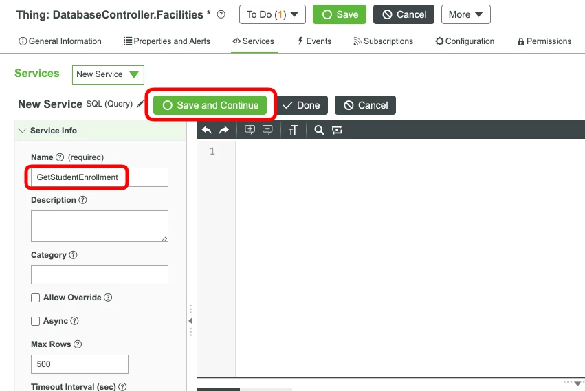

2. Create a new service of type SQL (Query) called GetStudentEnrollment.
3. Click Save and Continue to save your changes.
4. Add a parameter to the service title email. It will have a String base type and be required.
5. Add the following query to the canvas.
SELECT person_key, person_name_first, person_name_last, course_key, course_name, course_professor
FROM Person person
INNER JOIN PersonCourses pc ON person.person_key = pc.person_key
INNER JOIN Courses courses ON courses.course_key = pc.course_key
WHERE person.person_email = [[email]]​
6. For the output of the service, InfoTable should be there by default. If not, switch the output to be an InfoTable. For the Data Shape, set it to the Data Shape we just created, DataShape.StudentCourses.
