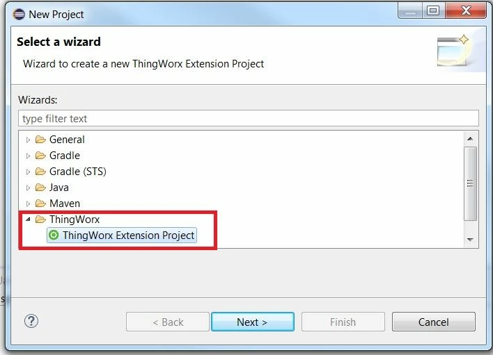

To create a new extensions project in the ThingWorx Extension Perspective, follow the steps below to get started:
  1. Go to File->New->Project.
  2. Click ThingWorx->ThingWorx Extension Project.
  3. Click Next.
  4. Enter the Project Name (for example, MyAwesomeExtension).
  5. Select Ant as your build framework. Gradle can be used if you are using a version of Eclipse that supports Gradle STS.
  6. Enter the SDK location by browsing to the directory where the Extension SDK zip is stored.
  7. Enter the Vendor information (for example, ThingWorx Labs).
  8. Change the default package version from 1.0.0 to support extension dependency.
  9. Click Next then click Finish. Your newly created project is added to the Package Explorer tab.

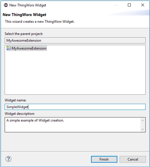

Creating Widgets
The ThingWorx Extensions SDK allows for easier development and in a shorter timeframe. The SDK provides steps for creating widgets, starting with an initial setup. Follow the steps below to get started on your own widget creation.
  1. Choose the ThingWorx menu and select New Widget.
  2. Select the parent project, in this case MyAwesomeExtension.
  3. Enter SimpleWidget for the name and A simple example of Widget creation. for description.
  4. Click Finish.

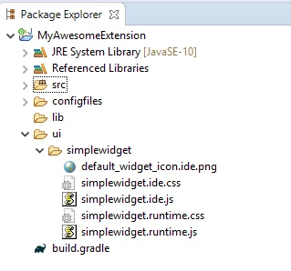

A new folder under the /ui folder is created and contains the JavaScript and CSS files for the widget. The metadata.xml file under the configfiles directory is updated automatically. The generated JavaScript files contain a minimal implementation of the functions needed to produce a working widget.

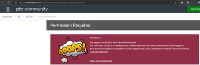

Unable to view Part 2 of the guide.  I get the following:
Not able to see the second part of the guide. same issue as @AndyHilton is facing
AndrewK
Community Manager
Hi @GAjey and @AndyHilton Some of these "here" links were incorrect. I think I've fixed them all, but if you run into anymore broken links @mention or pm me and I'll take care of them.
