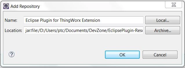

  3. After the Install window opens, click Add to add the Eclipse Plugin repository.
  4. Click Archive… and browse to the directory where the Eclipse Plugin zip file is stored and click Open.
  5. Enter a name (for example, Eclipse Plugin).
  6. Click OK.

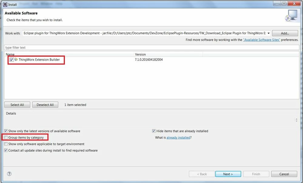

  7. Ensure that the Group items by category checkbox is not selected.
  8. Select ThingWorx Extension Builder in the items list of the Install window.
  9. Click Next and the items to be installed are listed

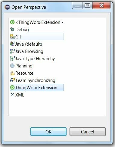

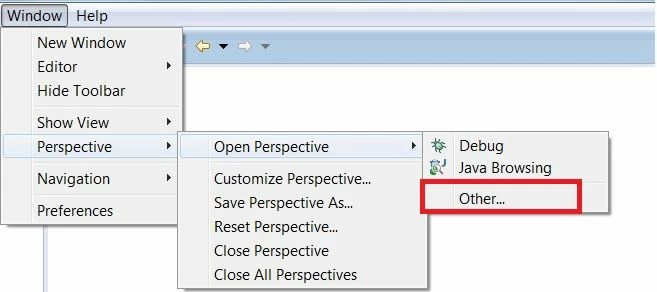

  13. When Eclipse starts again, ensure that you are in the ThingWorx Extension perspective. If not, select Window->Perspective->Open Perspective->Other->ThingWorx Extension, then click OK.
    NOTE: Opening any item from File->New->Other…->ThingWorx will also change the perspective to ThingWorx Extension.
