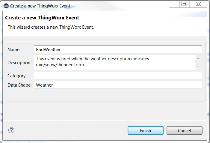

In this part of the lesson, we will create an Event: BadWeather that updates weather information inside the service UpdateWeatherInfo when the weather description indicates either storm/snow/rain.
  1. Create a property AlertNotification with a baseType STRING using the Add Property feature of the plugin we discussed before.

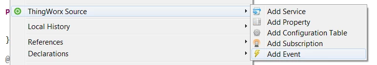

  2. Right click inside your java file->ThingWorx Source->Add Event.
  3. Set the name to BadWeather and set a name for the Data Shape to Weather.
    NOTE: This custom Data Shape has to be created in Composer. Importing Datashapes and other custom entities created in Composer into your extension will be discussed later in the tutorial. Our DataShape Weather includes one field called WeatherDescription with a STRING base type.
  4. Click Finish.
    NOTE: This will create annotation for your EventDefinition.

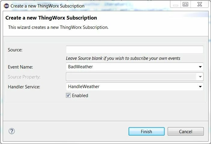

In this part of the lesson, we will create a Subscription: HandleWeather, which is a service that gets called whenever the BadWeather Event is fired. The subscription service HandleWeather updates a property called AlertNotification.

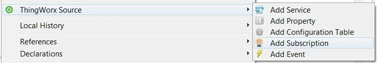

  1. Right click inside your java file ->ThingWorx Source->Add Subscription
  2. Set the Event Name to BadWeather and Handler Service to HandleWeather.
    NOTE:
    This means that whenever the BadWeather event is fired, the HandleWeather service will be executed. Source is left blank if the event belongs to the same template.
  3. Click Finish. This creates annotation for subscription service and also creates a new service called HandleWeather.

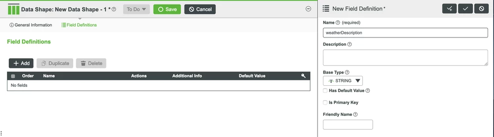

In this part of the lesson, we'll create a DataShape.

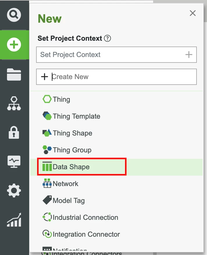

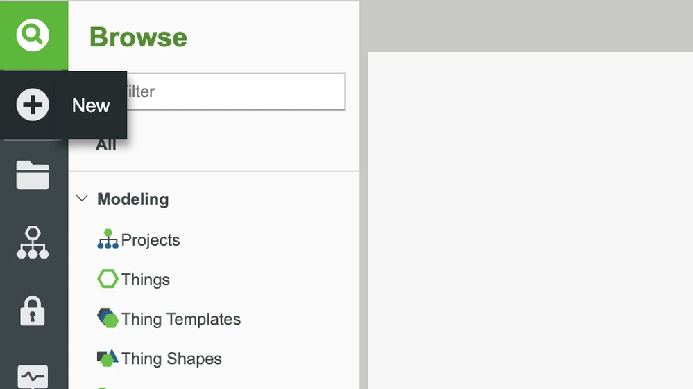

  1. Go to ThingWorx Composer. Click the + button.
  2. In the dropdown, select Data Shape.
  3. Enter a name, for example: Weather.
  4. Add a Field Definition weatherDescription with baseType STRING.

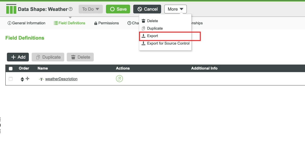

  5. Click check mark in the top left, then Save.

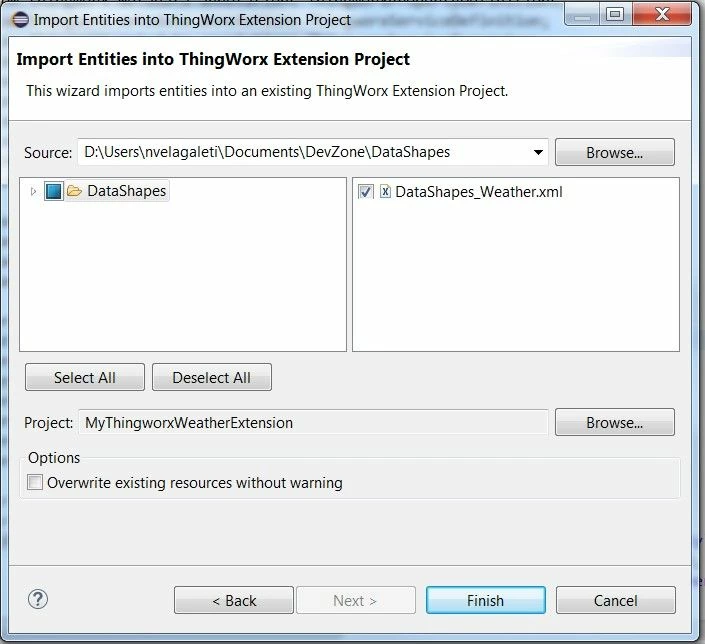

  6. Click the More drop-down, then click Export. Export the DataShape entity from Composer, it will download in your system as an xml file.

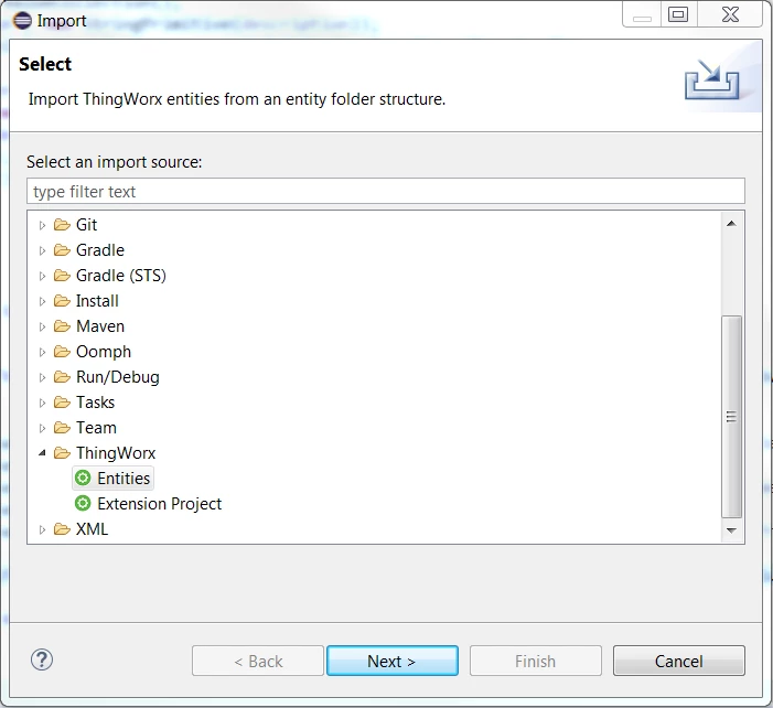

  7. Go back to Eclipse, right-click on your project ->Import..->ThingWorx->Entities.

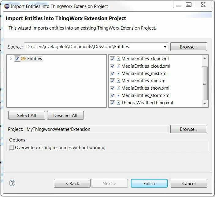

  8. Click Next. Browse to the directory where the xml file was downloaded. Select the xml file and Click Finish.
    NOTE
    : This adds the xml file to the Entities folder in your project.
  9. Following the same procedure, import other entities required for this Extension stored in the Entities folder of the download we provided for this training.
    NOTE: You can uncheck the box for importing DataShapes_Weather.xml, if you already loaded your Datashape in the previous steps.
