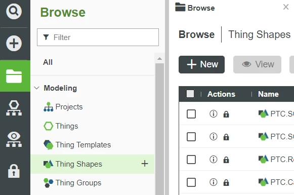

- Start on the Browse folder icon tab of ThingWorx Composer.

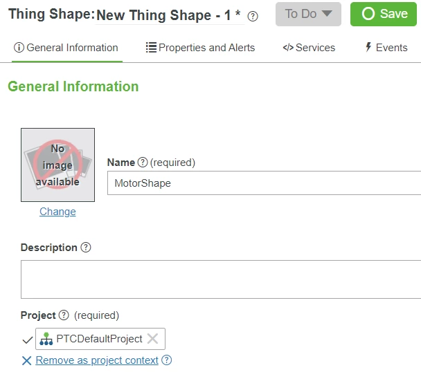

- Under the Modeling section of the left-hand navigation panel, hover over Thing Shapes, then click the + button.
- Type MotorShape in the Name field.
- If Project is not already set, click the + in the Project text box and select the PTCDefaultProject.
- Click Save.

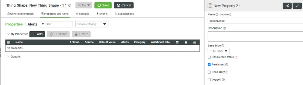

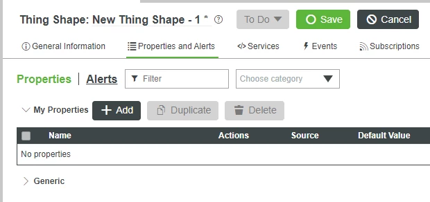

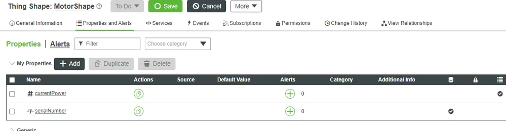

- Click the Properties and Alerts tab at the top of your Thing Shape.
- Click + Add.
- Enter the Property name from the first row of the table below into the Name field of the Thing Shape.
Name | Base Type | Persistent? | Logged? |
serialNumber | String | X | |
currentPower | Number | X |
4. Select the appropriate Base Type from the drop-down menu.
5. Check Persistent and/or Logged according to the table.
NOTE: When Persistent is selected, the Property value will be retained when a Thing is saved. Properties that are not persisted will be reset to the default after every Save of the parent Thing. When Logged is selected, every Property value change will be automatically logged to a specified Value Stream.
6. Click ✓+ button.
TIP: When adding multiple Properties at once, click Done and Add after each, once you've entered a Name, selected a Base Type and any other criteria. If adding a single Property, click Done.
7. Repeat steps 2 through 5 for the other Properties in the the table.
8. Click the done ✓ Button. You'll see that these Properties have been created for the Motor Thing Shape.
9. Click Save.

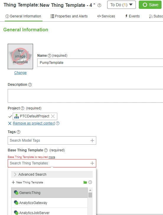

- Start on the Browse folder icon tab on the far left of ThingWorx Composer.
- Under the Modeling section of the left-hand navigation panel, hover over Thing Templates and click the + button.
- Type PumpTemplate in the Name field.
NOTE: Thing Template names are case-sensitive.
4. If Project is not already set, click the + in the Project text box and select the PTCDefaultProject.
5. In the Base Thing Template box, click + to choose GenericThing as the Template.

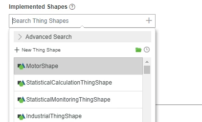

6. In the Implemented Shapes field, click the + to select the MotorShape Thing Shape.
7. Click Save.

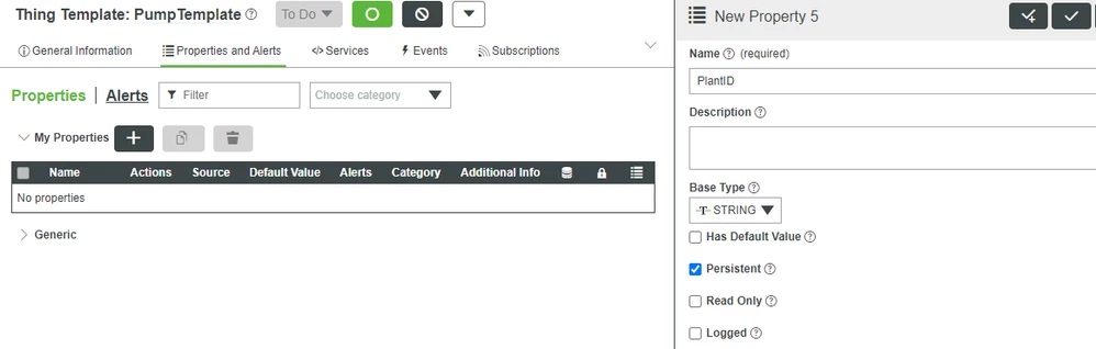

- Select the Properties and Alerts tab under Thing Template: PumpTemplate.
- Click the Edit button if the Template is not already open for editing, then click + Add next to My Properties.
- Enter the Property name in the Name field copied from a row of the table below.
Name | Base Type | Persistent | Logged |
PlantID | STRING | x | |
plant_lat_long | LOCATION | x | |
watts | NUMBER | x | x |
4. Select the Base Type of the Property from the drop down menu.
5. Check the appropriate Persistent and Logged check box.
NOTE: When Persistent is selected, the Property value will be retained when the parent Thing is saved. Properties that are not persisted will be reset to the default during a system restart and whenever the Thing is saved. When Logged is selected, every Property value change will be automatically logged to a specified Value Stream.
6. Click the ✓+ button.
TIP: When adding multiple Properties at once, click Check+ after each, once you've entered a Name, selected a Base Type and any other criteria. If adding a single Property, click Check button.
7. Repeat steps 3 through 6 for each of the Properties in the rows of the table.
8. After entering the final Property, click the ✓ button.
9. Click Save.

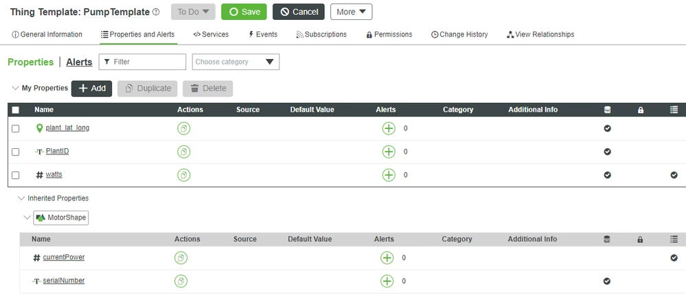

You should see the following Properties in your Composer.
