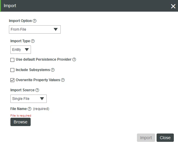

  1. In the bottom-left of Composer, click Import/Export.
  2. Click IMPORT.
  3. In the Import pop-up, keep the default values and click Browse.
  4. Navigate to the Sessions.xml file you downloaded. Select it and click Open.
  5. Click Import in the Import pop-up.
  6. Click Close to close the pop-up.

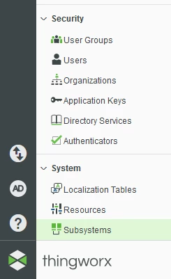

  1. Click the Browse folder on the left-hand side.
  2. Under System, select Subsystems.

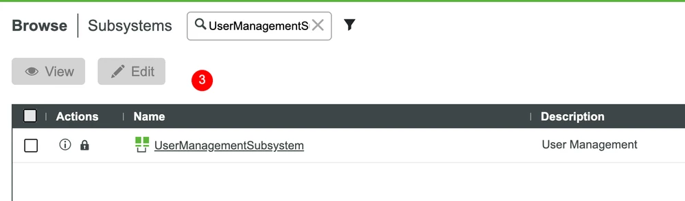

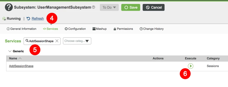

  3. Filter for UserManagementSubsystem and open it in Edit mode.
  4. Select Services.
  5. Filter for the AddSessionShape Service.
  6. Click the Play button to open the Execute window.

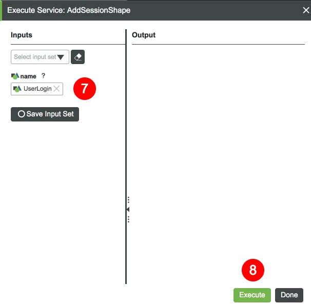

  7. Enter UserLogin (the provided ThingShape) as the name input field.
  8. Click Execute.

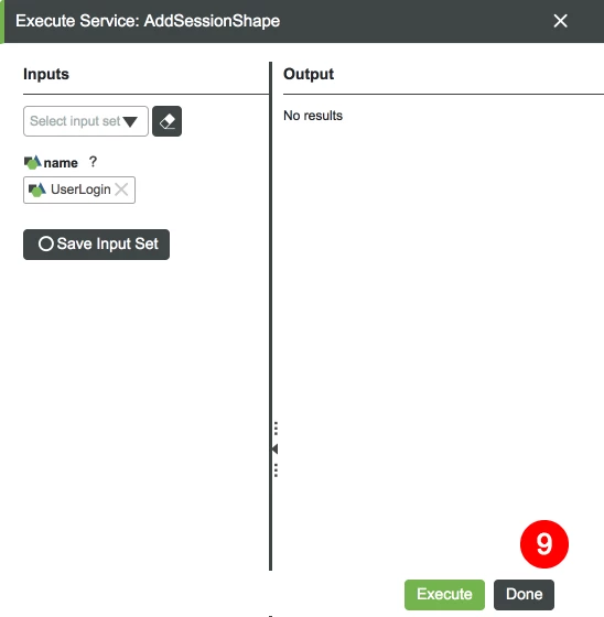

  9. Click Done.
You've just created your first Session Parameter. These values are used for content held in a cookie for a website or information that might be static for the User or session.

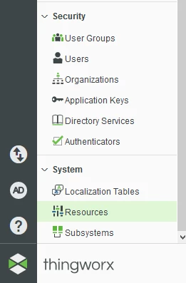

  2. Under System, select Resources.

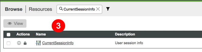

  3. Filter for CurrentSessionInfo and open it.

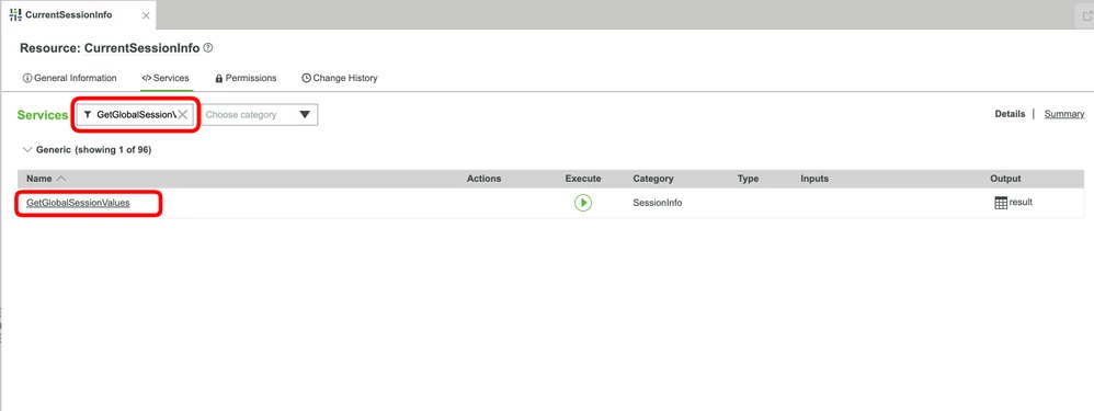

  4. Select Services.
  5. Filter for the GetGlobalSessionValues Service.

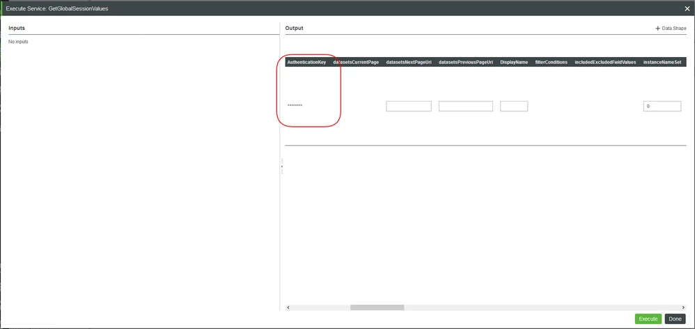

  7. Click Execute. You will notice the result is a list of the properties in the UserLogin ThingShape. Your result might differ from mine.
  8. Click Done.
