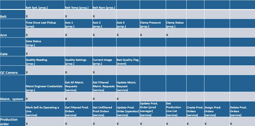

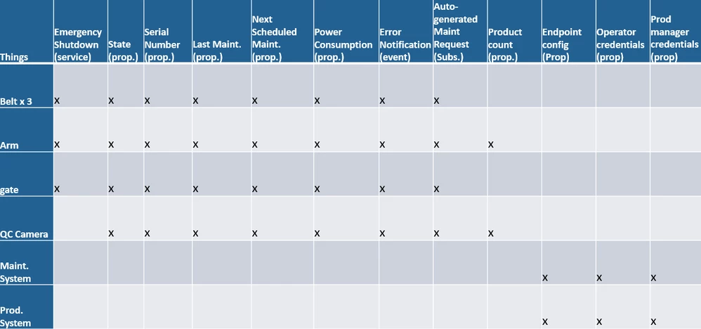

Overlapping Matrix
This matrix represents all of the overlapping Components that are shared by multiple types of Things in our system:
Unique Matrix
This matrix represents the unique Components to each type of Thing:

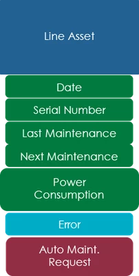

Step 3: LineAsset Thing Template
After prioritizing and grouping common functionality and information, we came up with the list below for the first Thing Template to create, LineAsset with five Properties, one Event, and one Subscription. The breakdown for the LineAsset Thing Template is as follows:

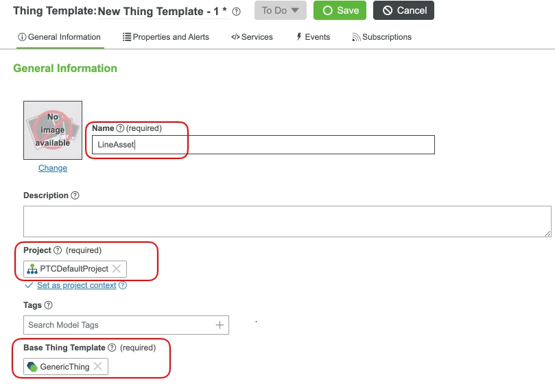

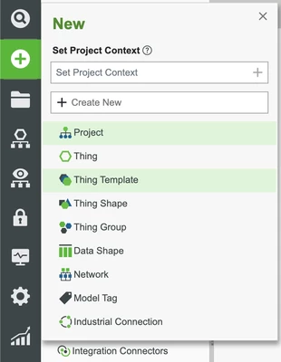

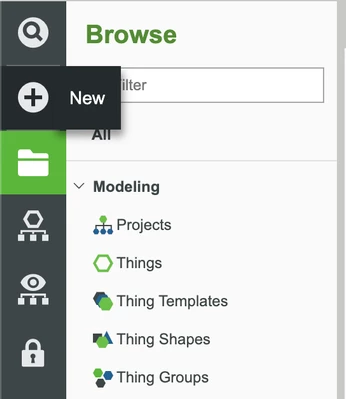

  1. In the ThingWorx Composer, click the + New at the top of the screen.
  2. Select Thing Template in the dropdown.
3. In the name field, enter LineAsset and set the Project (ie, PTCDefaultProject).
4. For the Base Thing Template field, select GenericThing.
 5. Click Save.

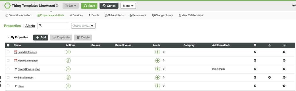

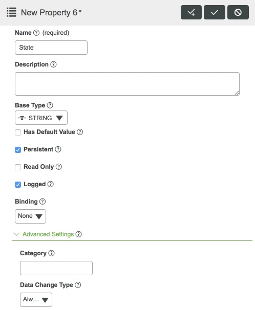

 6. Switch to the Properties and Alerts tab.
 7. Click the plus button to add a new Property.
The Properties for the LineAsset Thing Template are as follows:
Name
Base Type
Aspects
Data Change Type
State
String
Persistent and Logged
ALWAYS
SerialNumber
String
Persistent, Read Only, and Logged
NEVER
LastMaintenance
DATETIME
VALUE
NextMaintenance
DATETIME
VALUE
PowerConsumption
NUMBER, Min Value: 0
ALWAYS
Follow the next steps for all the properties shown in our template property table.
  1. Click Add.
  2. Enter the name of the property (ie, State).
  3. Select the Base Type of the proprty from the dropdown.
  4. Check the checkboxes for the property Aspects.
  5. Select the Data Change Type from the dropdown.
  6. Click Done when finished creating the property.
Your properties should match the below configurations.

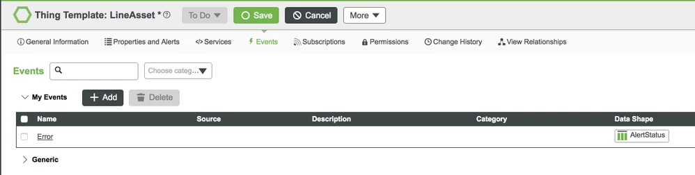

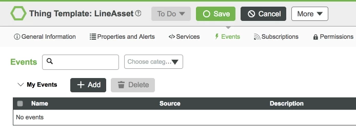

Line Asset Event
  1. Switch to the Events tab.
  2. Click Add.

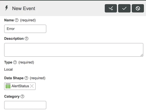

  3. Enter the name of the Event (ie, Error).
  4. Select AlertStatus as the Data Shape. This DataShape will allow us to provide simple information including an alert type, the property name, and a status message.
  5. Click Done.
Your Event should match the below configurations.

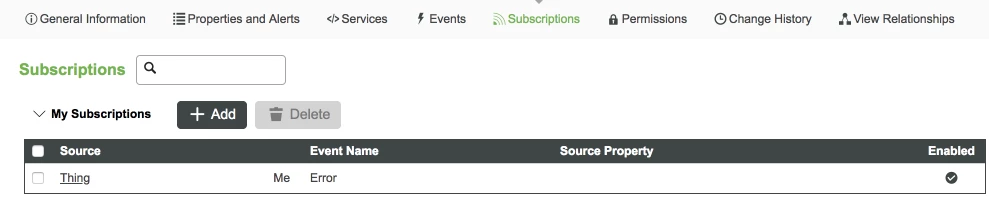

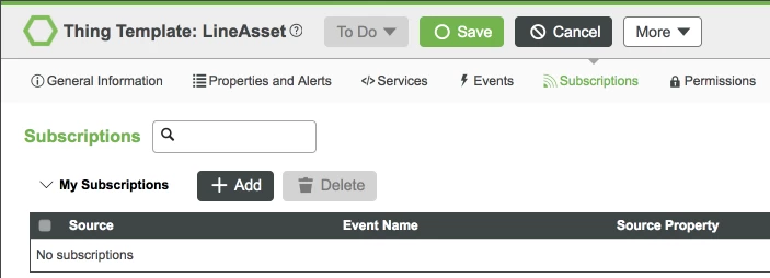

Line Asset Subscription
  1. Switch to the Subscriptions tab.
  2. Click Add.

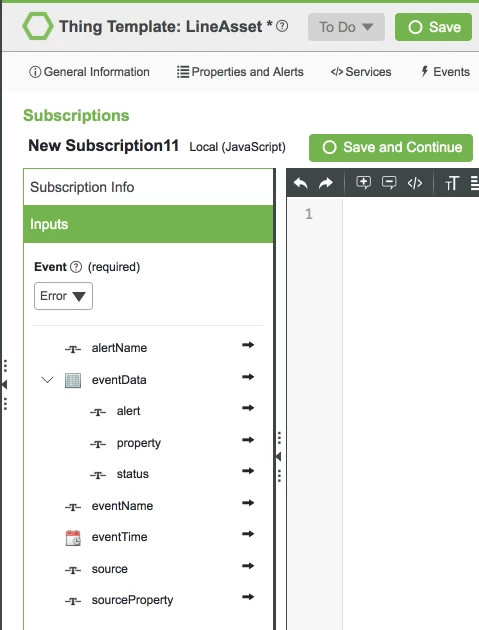

  3. Check the Enabled checkbox.
  4. Switch to the Inputs tab. Select the name of the Event (ie, Error).
  5. Click Done.
Your Subscription should match the below configurations.
Challenge Yourself
We have left the Subscription code empty. Think of a way to handle Error Events coming from your line asset and implement it in this section.
