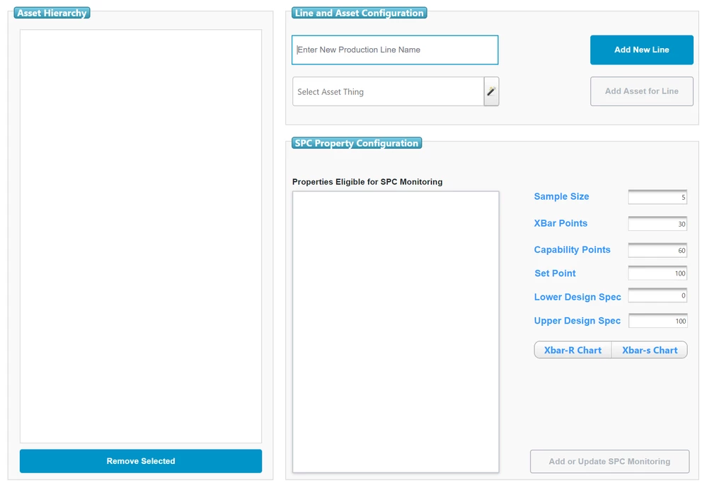

Step 2: Configure Properties for SPC monitoring
You may configure SPC monitoring for multiple production lines, connected assets on those lines, and time-series Properties on those assets using the SPC accelerator.
This is done by viewing the PTC.SPC.Configuration_MU Mashup.
Follow these steps to configure an SPC Property.

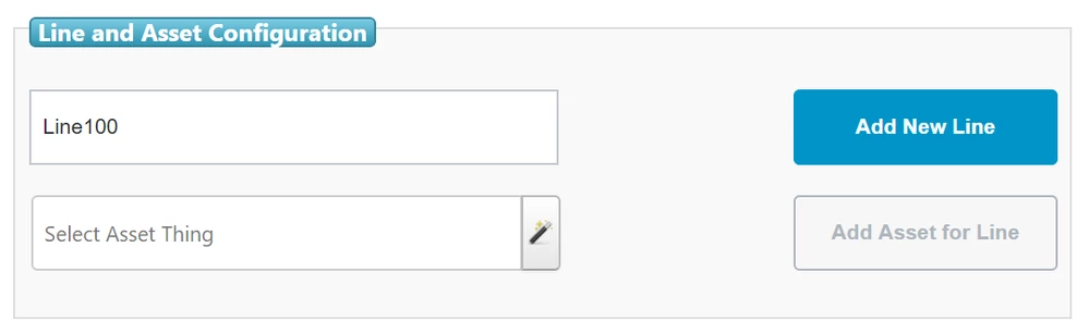

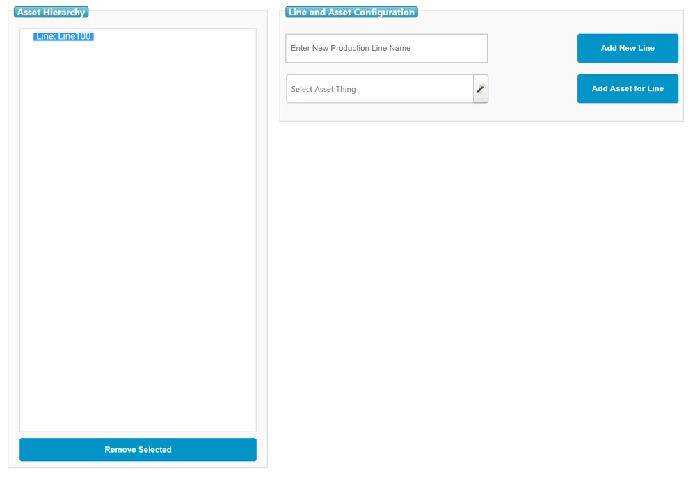

Create a new production line
  1. In the Enter New Production Line Name text field, type Line100.
  2. Click Add New Line.
  3. Now you will see the new production line added to the Asset Hierarchy tree along the left.
  4. All production lines you’ve created (as well as their assets and the assets’ Properties) will be shown here.
  5. In the lower-right, the SPC Property Configuration area has disappeared because the item selected in the Asset Hierarchy tree is the new line; only assets within lines can have streaming Properties.

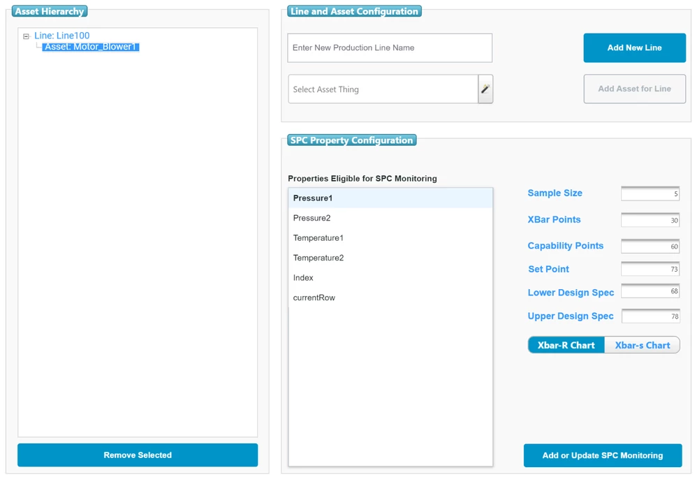

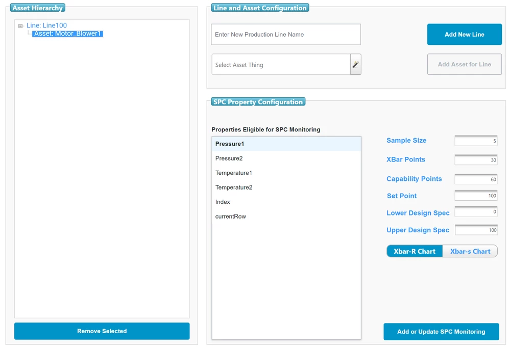

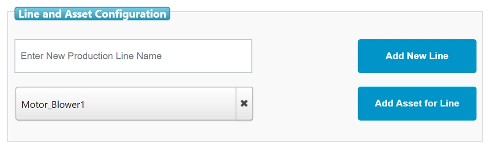

Add a streaming asset to Line100
  1. Within the Select Asset Thing entity picker, type Motor_Blower1.
  2. Click Add Asset for Line.
  3. This asset has Properties that are streaming into ThingWorx.
  4. Multiple assets can be added to the same production line by selecting the line from the Asset Hierarchy tree and following the steps above.
  5. If you select the new asset from the Asset Hierarchy tree, you will see that the list of Properties Eligible for SPC Monitor is shown in the SPC Property Configuration area.
  6. All Properties have the same default configuration associated with them.

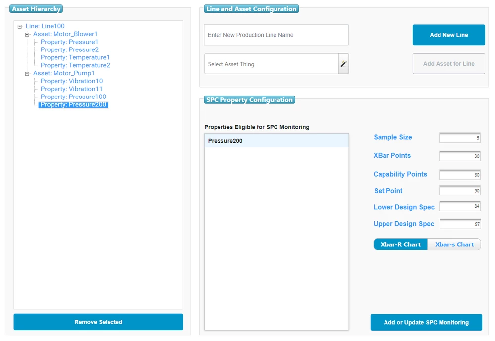

  1. Select Pressure1 from the list of eligible properties.
  2. Enter the following values:
     Properties                      Values
    Sample Size 5
    Xbar Points 30
    Capability Points 60
    Set Point 73
    Lower Design Spec 68
    Uppder Design Spec 78
3, Select Xbar-R Chart.
4. Click Add or Update SPC Monitoring.
5. Pressure1 is added to the Asset Hierarchy tree underneath the Motor_Blower1 asset.
6. If you select this Property, you can modify the configuration and save it by clicking Add or Update SPC Monitoring.

100 Motor_Blower1 Pressure1 5 30 60 73 68 78 Xbar-R
100 Motor_Blower1 Pressure2 5 30 60 78 68 89 Xbar-R
100 Motor_Blower1 Temperature1 5 30 60 50 44 56 Xbar-s
100 Motor_Blower1 Temperature2 5 30 60 85 73 97 Xbar-s
100 Motor_Pump1 Vibration10 5 30 60 150 108 190 Xbar-s
100 Motor_Pump1 Vibration11 8 60 100 200 168 220 Xbar-s
100 Motor_Pump1 Pressure100 5 30 60 100 84 118 Xbar-R
100 Motor_Pump1 Pressure200 5 30 60 90 84 97 Xbar-R
  1. As you add assets to Line100 and configure their Properties, you will see the Asset Hierarchy tree grow.
  2. If you need to remove an asset or its associated Properties from the Asset Hierarchy tree, you may select that item, and click Remove Selected.
  3. For any item you remove, its child-items will also be removed.
